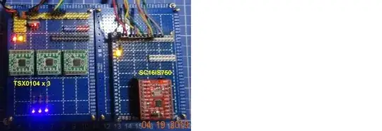

I used to use four TXS0104 logical level converters to demux one UART channel into 4. I select one one of the four channels by enabling TXS0104 converter I want. It works smoothly, except you can not use more than one UART channel at the same time.

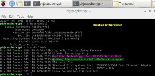

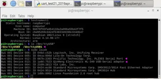

I also tried the USB to TTL adapters for Rpi3B+ Raspbian version 2019Apr. I found both PL2302 and CH340 adapters can be detected without first installing drivers.
In other words, Raspbian version 2019apr already have Pl2303 and CH340 drivers preinstalled.

NXP SC16IS750 I2C/SPI to UART Module Not Recommended for Newbies
SparkFun once sold a NXP I2C/SPI to UART module. I thought it too good to be true to be able to have as many UART channels as I wanted. But then I found the datasheet has some "special features" which are perhaps OK for hackers to deal with, but too hard for newbies to handle. I tried hard for a couple of days before giving up. SparkFun has now discontinued this module for a reason.
The other modules AdaFruit are recommending are TXS/TXB0108 modules. I have been using TSX/TSB0104s for demultiplexing UART/I2C/SPI channels and found them OK, if not too greedy to entertain too many channels at the same time. Actually I found many I2C modules (including MCP23017) when grouped more than two, become unstable and difficult to troubleshoot. Perhaps I have not learnt all the tricks in fiddling the I2C pull up resistors. Anyway, trying just one is OK for newbies.
Another thing is that I tested both TSX and TSB versions and found TSB more reliable. I also noticed that AdaFruit only sells TSB now and no loner TSX. This are the puzzles I never solved.

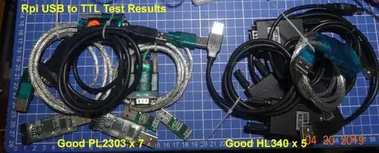

I checked out more than 20 very old USB to TTL adaptors which have been collecting dust for over 10 years. I bought some of them for WinXP and found they no longer working for Win7. I also bouoght some for Win7, and found them no good for Win10. Just now I tried all these old guys for my Rpi3B+ Raspian 2019Apr to see if I had any luck. Surprisingly I found the following:
Bad = 5 (not sure which driver) Good HL340 = 5 Good PL2302 = 7
testing usb to ttl adapters
