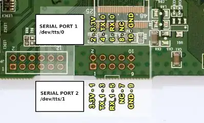

I was working on a project that 'debricks' my bricked router(WRT54GL). Since this is my first time with Serial communication on any device, I have some questions to ask.
WRT54GL Pinout
This is the pinouts for the router that I would like to debrick. I am planning to connect those pins with my Raspberry Pi 4 with GPIO pins.
I have found out that Raspberry Pi supports UART connection by default. However, Raspberry Pi has only one pair of RX(GPIO 15) and TX(GPIO 14). This is the point that I get some confusion and decided that I should ask you about this question.
Question 1. What is the name of that 10 Pin layout from my router? Does this have any name? or is it just a 'Serial' layout?
Question 2. If I connect the RX(GPIO 15) and TX(GPIO 14) from my Raspberry Pi to this router RX_0 and TX_0 only(yes with RX_1 and TX_0 both unconnected), would it work? (I assume not) or do I have to pair all two TXs and RXs between Raspberry Pi and router?
