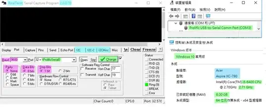

Update 2019may17hkt1628

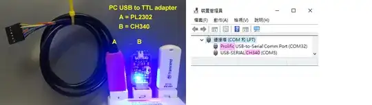

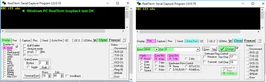

In case loopback /dev/serial0 works but /dev/ttyACM0 does not work, then it might be the external USB problem. I usually recommend to use the powerful RealTerm to do troubleshooting. You might might read the details in the second reference below. RealTerm can send/receive long strings of file, store data in files, new line setting, etc. So it is much faster than python and the not so powerful puTTY or TeraTerm. I show below a couple of screen captures for your reference. You might also like to read SparkFun for their recommendation of RealTerm (see reference below). And in case you are trying USB/TTL cables, good quality USB cable is also important. I usually recommend CH340 drivers, though Raspbian accepts PX2xxx drivers OK.
superterm 1
superterm 2
usb serial cable
