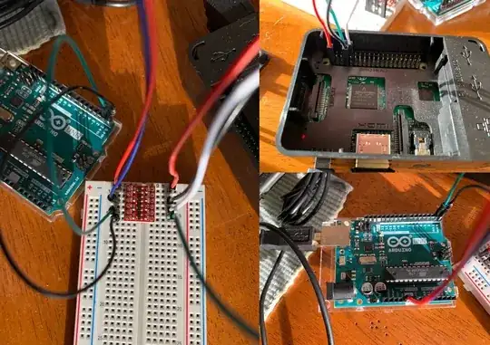

I'm trying to connect my Arduino to my Raspberry Pi using the GPIO pins. I understand that the Pi uses a 3.3V signal while the Arduino uses a 5V signal so I bought a bi-directional logic level converter to convert them. Here are some shots of my current setup.
Pi to Arduino
I've been using this article as my guide: Raspberry Pi Serial (UART) Tutorial. As you can see from my pictures, I have it wired in the same way that they describe.

Based on your picture, and in addition to what jsotola said about soldering the pins on the level converter, you have not connected the high voltage (HV) and low voltage (LV) pins to the appropriate power source. HV needs to be connected to the Arduino's 5 volt supply and LV needs to be connected to the Raspberry Pi's 3.3 volt supply. Without those connections the level converter will not work.

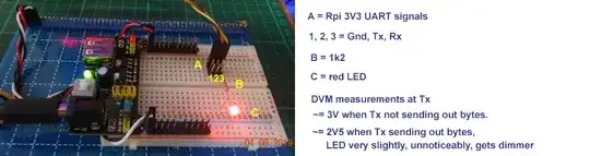

All newbies need to understand and explain the following. If Tx is connected to 1k and LED then Ground, multimeter would find Tx ~=3V if not sending bytes out, and ~=2V5 when sending something; LED grows dimmer, but not at all noticeable to my very dull human eyes.

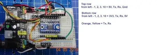

Yes, I am also testing a 8 channel bidirectional module, based on TSX018E.
UartBlink blink both LEDs connected to 3V Tx and 5V Tx, verifying that the TSX0108E level shifter is working OK. Below is the youtube video (Left side is 3V3 Tx Led, right side 5V Tx Led.
UartBlink blinks both 3V3 Tx Led and 5V Tx Led
Note - OP's logical level converter picture is not very clear. It appears that Hv pin is not connected.

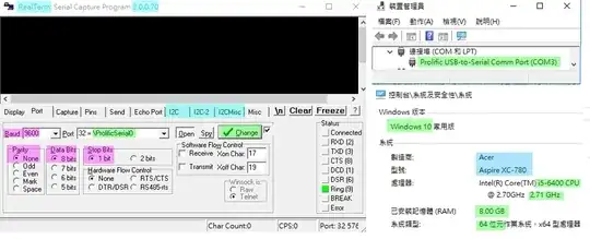

Rpi UART to talk to PC Win10 RealTerm, then BlueTooth serial Module

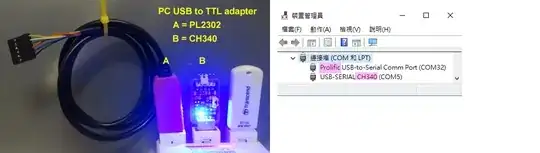

So I am following OP's tutorial to first let RPi to talk to a serial terminal. The tutorial recommend puTTY, but just now I googled and found SuperTerm seems better, because it has I2C staff which I would use later for other I2C projects. I downloaded SuperTerm and installed it without any problem. I appreciate the tutorial recommending the Prolific COM driver, because some months ago I tried other old drivers but found them not working.
realterm

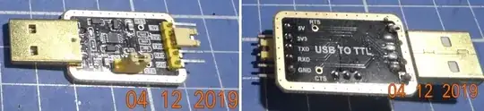

The tutorial recommends the PL2303 driver for the USB/TTL cable. But I often hear that CH3340 is better, more stable. So I plugged in the CH340. So now I have two UARTs, PL2302 at COM32, CH340 at COM5 to do loop back etc.
usb/ttl cable
Now I am testing the CH430 USB to TTL adapter. I think I will first try the loopback thing using RealTerminal.
CH430 USB TTL Adapter

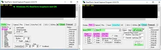

Now I connected the CH430 adapter's Tx to Rx, set the RealTerm configuration to 9600-8N1, CH430 Port9, and found monitor displaying echoed characters as I key at the keyboard.
Next step is to write a Rpi python echo program which input characters from PC Winodws CH430 adpater Tx, and eches back at the adapter's Rx terminal.
real term loopback test

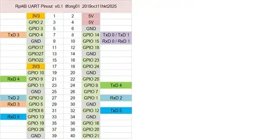

Appendix A - Rpi4B buster Multiple UART alternate function pinout
Rpi4B Multiple UART pinouts
