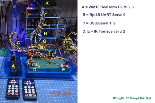

ir test setup 1
Update 2019sep22hkt2146
Now I have written a short python function to write to TxD the IR code of Button Digit 1: b'\xa1\xf1\x00\xff\xa6'. I have also used a scope to display the wave form, to make sure it is clear an sharp.
Now the signal goes from Rpi TxD to RxD of the IR transceiver, which should emit IR light to the other transceiver, whose TxD connects to Win10 RealTerm RxD pin, showing three bytes 0x00, 0xff, 0x16. Everything looks OK. So next step is to write a short python program to replace the RealTerm.

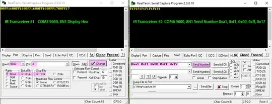

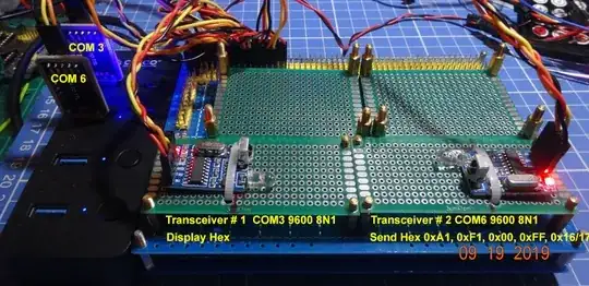

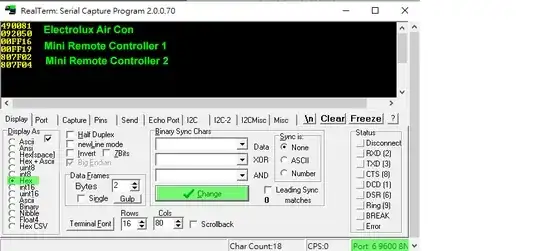

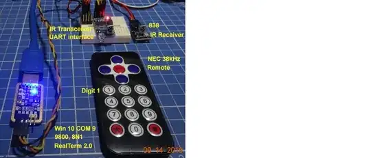

Now I am using Win10 RealTerm to replace lirc.IRsend and lirc.IRrecord to send and receive/decode IR codes to compile the lirc.conf file for the mini remote controller. So far so good. Next step is to use two python functions to replace the realTerm applications.
ir test 1
ir test 2
Update 2019sep19hkt1231
I tested my Electrolux air conditioner remote controller and two mini remote controllers and found them emitting code as expected. However, I could not find the lirc.conf file of my air con remote in the lirc remote database.
So I guess I need to use IRsend, IRrecord tools to find the code encoding and compile my own lirc.conf file (Ref 35, 36).
However, I found IRsend and IRrecord rather tedious and low level (socket level!). So I think I would cheat by using Python to emit and receive/decode IR signals, and try to compile a simple lirc.conf file for my mini remote controller.
Old Update 1
I used the remote to send IR codes by pressing buttons by hand
0, 1, 2, 3, 4, 5, 6, 7, 8, 9, *, #, ^, v, <, >, OK
and used Win 10 RealTerm to read the signals from UART interfaced IR receiver.
remote generated IR code

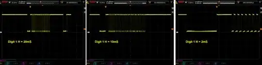

Now I have set up a test rig for looking at the IR signal generated by the mini remote controller. I press button Digit a and found the UART IR transciver geats the serial (9600, 8n1) byte of 0x00ff16. The scope displaced the raw signal which I guess is part of the NEC 38kHz signal for three hex digits 0x00, 0xff, 0x16. I guess I an use Rpi GPIO pin 17 to read this signal to convert to 0x00ff16, and decoded to mini remote controller button Digit 1.
ir test 1
ir test 2

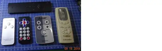

I am thinking of starting with my Electrolux air conditioner remote controller. This is a universal mini remote for many vendors, so should be a good reference and case study.
Now I found my air con remote and other two mini remotes can send IR code to the UART IR reader which receives and decodes and send results to realTerm. It is a bit tedious to manually press buttons and list the data logged in the realTerm terminal emulator. So I think it save time to do both IR sending, receiving, decoding, serial output to text files using python. This is what I will do next.
air con remote

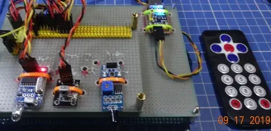

(1) Update 2019sep12hkt1258
Now I have found in my junk box the IR transceiver kit I bought for hacking my HDMI switch box. I guess the remote is the IR transmitter, the black little guy is the IR receiver, and the clear LED is status LED. I need to search the user guide. I bought the kit from TaoBo which usually does not bother to include and user guide. So I need to search PiHut and Hobby Electronics, ...
lirc toy

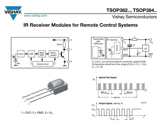

Now I am reading the Vishay TSOP1838 IR Receiver DataSheet and made a summary.
vishay tsoip1838

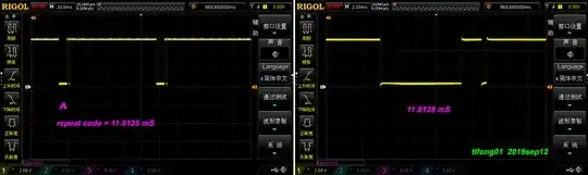

Now I am using the remote to repeatedly sending button numbere 1 to the receiver, and use scope to display the repeat number 1 signal.
repeat sending button number 1

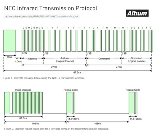

And I am studying the NEC IR protocol to see if my cheapie remote and indeed sending NEC codes.
NEC IR protocol

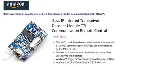

Now I am thinking of using the following module (Ref 19) to test the IR emitter.
uart ir transceiver

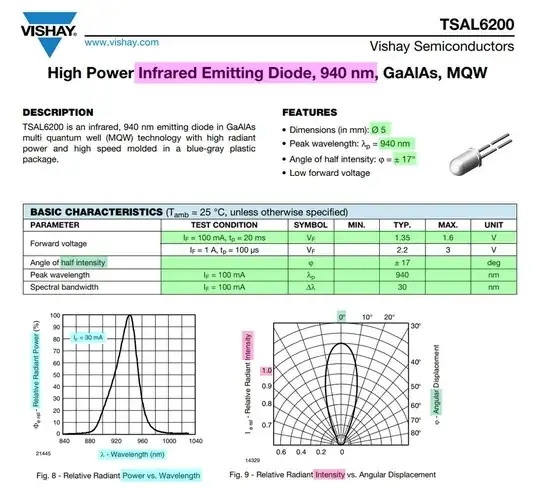

Now that I have more or less understand the NEC 38kHz encoding protocol, and also tested OK the 838 receiver, using the remote to manually generate the IR signals, next step is to look at the IR LED. I am studying Vishay's TSAL6200 940nM IR LED which I think is the most popular. I made a summary below. By the way, it took me some 10 minutes to understand funny looking Fig 9, Intensity vs Angle.
IR Emittinbg  LED

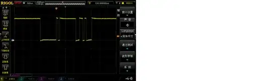

Remote Button Number 1 Signal Waveform Display
remote signal button number 1

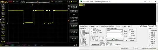

I am testing the UART interfaced IR emitter and received. The remote sends out signal by a stupid human finger pressing Button Number 1. UART then Rx receives the signal below. I need to check if it means any thing.
uart ir receiver
(8) Update 2019sep14hkt1420

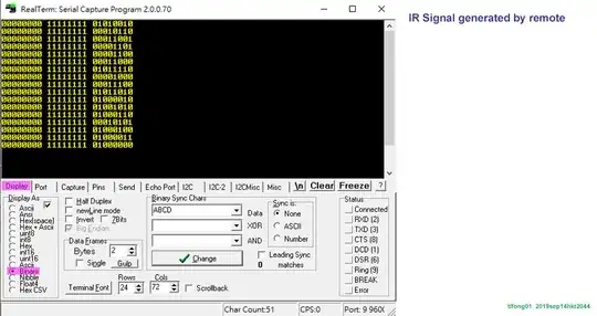

Now I am using the RealTerm terminal emulator (Ref 27) to read the NEC encoded IR signals sent by the manual remote controller, and received by the UART controlled IR receiver.
ir decoder
