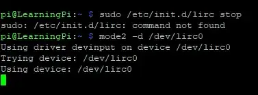

Im trying to get my Pi to take input from an IR remote using lirc. But it is not working. Ive tried a few different tutorials like this one that basically did the same thing.
One problem here is the the Pi couldnt find /etc/init.d/lirc, so i could not stop it. The test (mode2 -d /dev/lirc0) also fails, it does not tell me anything.

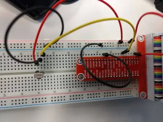

Also the wiring is like this enter image description here

Now you can test if you get signals. Start mode2 and push some buttons on your remote control. mode2 should show you very low level info in space and pulse:
rpi3 ~$ sudo systemctl stop lircd.service
rpi3 ~$ sudo systemctl stop lircd socket
rpi3 ~$ sudo mode2 --driver default --device /dev/lirc0
