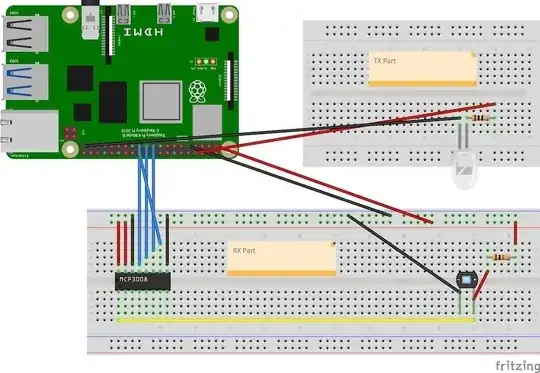

(1) I am trying to make somethin like visible light communication based on LED as independent TX part and photodiode with MCP3008 as RX part. I am attaching a photo of my circuit I currently use. The resristor on the TX part has 10 ohms resistivity and the resistor on the RX part has 10K ohms.

(2) I want to receive data on 10 kHz frequency (Code from the TX part: time.sleep(delay) delay is set to 0.0001). This is why I thought that I need to apply Nyquist sampling theorem. This theorem says: Sampling frequency shoult be at least 2-times higher as sampled frequency. So I used 22 kHz frequency on the SPI bus, because I thought that this is my sampling frequency for digital signal of LED (picture bellow - last line marked as 14 TXD). It does not work, so I was trying to find proper frequency to read some of the data and this is why I use 480,750 kHz. This frequency gives me the closest result for my data sent form TX.

(3) Unfortunately, I do not have a scope, so I can not show you exact shape of signals. I use a PISCOPE for some analysis (picture above). The bottom GPIO pin is for sending information using LED. I sent this sequence, which is capturend on the PISCOPE: 000011110101100101010001001111010011110100111110. The RX part recieve after some management this sequence: 1011001001000100111010011101 (First eight and last eught bits from TX sequence are cut, because those are only for communication starting and ending. There you cn see that a lot of bits are lost or doubled - this is why my RX sequence start with 1. The 1 is from start sequence, which has, as it seems to be, on bit doubled).
