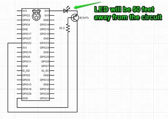

I'm building an IR blaster with an LED that will be wired 50 feet away from the circuit. I'm going to use this 18 gauge wire to extend the LED connection.
I'm using a GPIO pin connected to a BC547b transistor. The Pi and circuit will be kept together. The LED will be 50' away from the transistor and other components.
The LED works fine when it's powered by the Pi but I'm assuming 50' of wire will have significant losses and the Pi's power won't be enough. I'm OK with an external power supply but it'll need to be close to the Pi and the rest of the circuit. So, the power will be sent over the 50' of wire.
Would a 5v 0.5amp power supply be enough? How would that supply be added to the circuit?
EDIT: My schematic is wrong (transistor is NPN) but the physical circuit is correct and working.
Thanks!
Schematic
