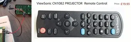

I am trying to record the IR codes from my projectors remote. Nothing seems to be working and I need some help.
I want to be able to directly record the IR signals that my remote is putting out when a button is pressed.
My thinking is that I just need to solder some wires to "tap" the IR LED and feed those wires into the GPIO on the Pi.
I do not have an IR receiver sensor, and dont really want to order one. At this point I want to get this idea to work as a proof of concept.
Currently I have the folliwing: Raspberry Pi 3b+ (buster) Optoma HX180X projector Projector Remote Control (random remote control model number is CN1082)
I have LIRC installed on my Pi. I used the following forum post to install it. It seems like the only legit way to install it. https://www.raspberrypi.org/forums/viewtopic.php?f=28&t=235256
I soldered a wire to the + and - of the IR LED. I plugged the + wire into PIN18 GPIO of my PI. I plugged the - wire into the ground of my PI (I tried using a shard ground, no ground, floating ground... nothing seems to work).
There are three issues I am running into: 1. Some times the IR LED is "ON" 100% of the time. When everything is plugged in to the PI I can see the LED is 100% lit (using my cell phone camera). When I unplug the GPIO or the Ground it shuts off. Not sure if this is due to the GPIO outputting a voltage for some reason I have it set to input, or an issue with the LED diode voltage being exceeded, or the ground not being correct so it is... I have no clue! 2. Some times I can get it to not be "ON" 100% of the time, and then I can run mode2 in LIRC, but it just spams SPACE 2 PAUSE 2 SPACE 3 PAUSE 3 SPACE 2.... fills up the console instantly. 3. I cant even use -f with irreecord to get the non-gapped signals.
Ive tried pullup and pull down resistors, neither did anything.
Does anyone have any advice on how to make this work. I have been trying everything and feel that I am missing something super obvious.
Please help!
Thanks!!

The OP wants to read the output voltage of the IR LED output of his CN1082 remote. So he connects one wire seemingly directly to one end of the IR LED (not sure anode or cathode, he says "+") to Rpi GPIO pin 18, another wire to Rpi Ground.
The OP had no luck. How to fix it?
cn1082 remote
/ to continue, ...
Not sure if the OP's remote uses 1.5V x 2 = 3V batteries, or a 6V button cell. If 6V is used to power the remote, then the OP's Rpi might have already fried, because connecting the GPIO pin, whether with or without any current limiting, voltage dividing resistor, might trigger a "latching up" thing, frying the Rpi immediately, in 15 minutes, or shortening the life of the Rpi.

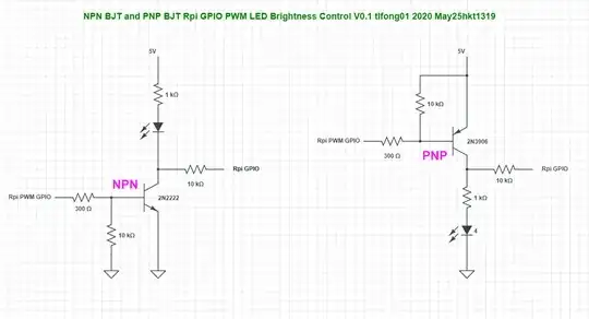

Usually an NPN or PNP BJT switch is used to switch on/off the IR LED, as show in the schematic below.
Now that we have two scenarios: NPN story and PNP story. Perhaps the OP can use a multi-meter (does he has one?) to verify the remote is using an NPN or PNP switch. If he does not have, or doesn't know how to use any multimeter, then we can make wild guesses and do trials and errors, using other GPIO pin, because GPIO pin18 is also fried, if not the whole Rpi.
npn pnp switch

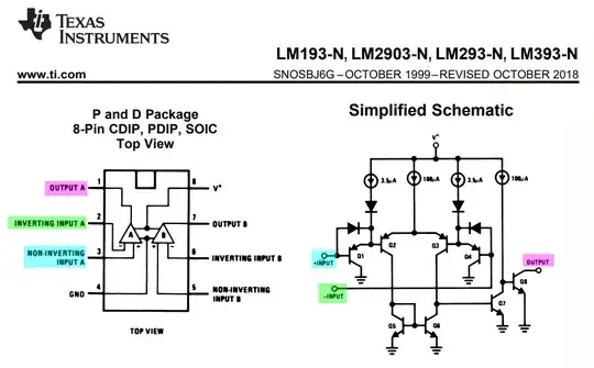

(3) LM393 Low-Power, Low-Offset Voltage, Dual Comparators - TI

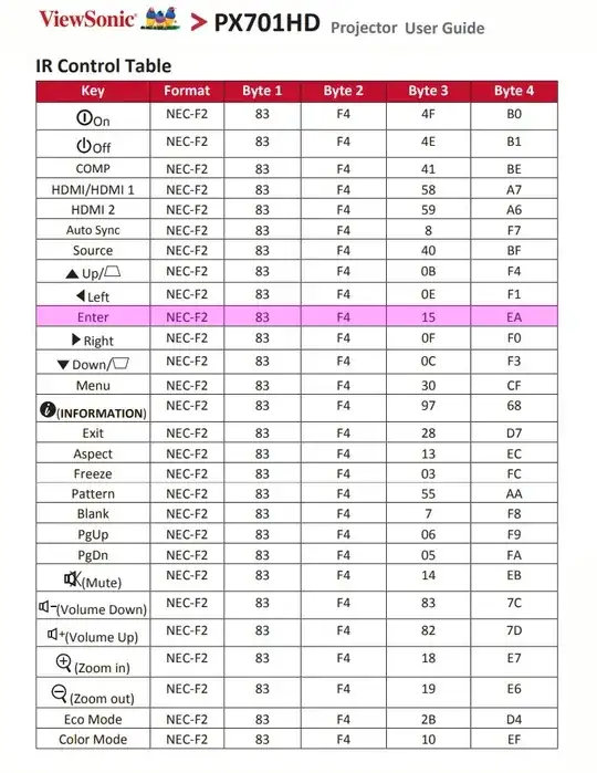

(7) ViewSonic PX701HD Projector User Guide (Page 62 IR Control Table)

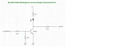

Fig 1 - Rpi GPIO IR LED
Rpi GPIO IR LED
Fig 2 - LM293 Summary
lm293 summary
Fig 3 - CN1082 IR Control Code Table
cn1082 ir code talbe

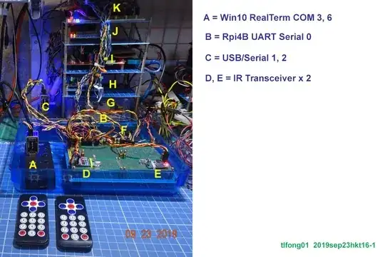

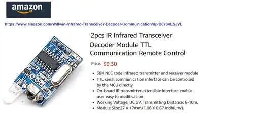

List 1 - Test Sending IR Code UART Transceiver Module
(8) Python IR Code Testing Program firc71.py
uart ir transciver 1
uart ir transceiver 2
uart ir transceiver 3

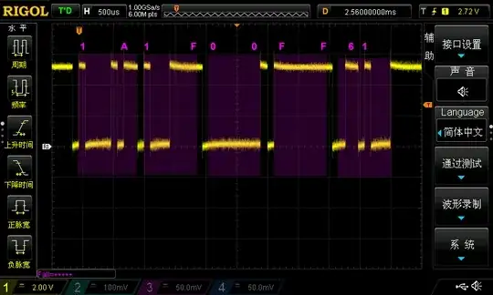

# Test 2   - Repeat send bytes in databyte array, using scope to display TxD signal waveform
