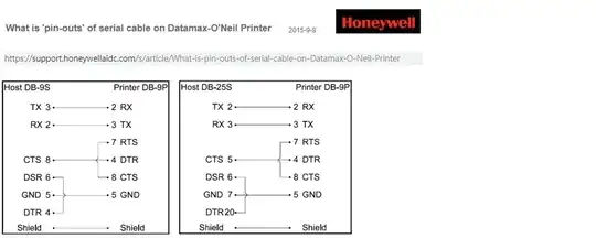

Why Rpi cannot pretend to be a serial printer, receiving printer data stream from WinPC?
Well, WinPC to Rpi can send and receive text over UART without any problem.
But for WinPC to print something, Win need to handshake with the printer first. For example, WinPC might say, "OK, so are you a printer?" If WinPC gets the reply from the other side such as "Yes, I am a printer, send over stuff to print". Then WinPC starts sending something.
In other words, WinPC and Rpi need to speak a printer language.
Moreover, the simplest WinPC/Rpi serial cable may consists of only 3 lines, TxD, RxD, and Ground. But many serial cables for printers may contains up to 9 lines for miniature serial cables (DB9) and up to 25 pins for standard serial cables (DB25). The extra signals beside TxD, RxD are CTS (Clear To Send), RTS (Request to send) etc. See Appendix A below for more details.

Appendix A - Honeywell Printer Cable Example
honeywell printer cable
