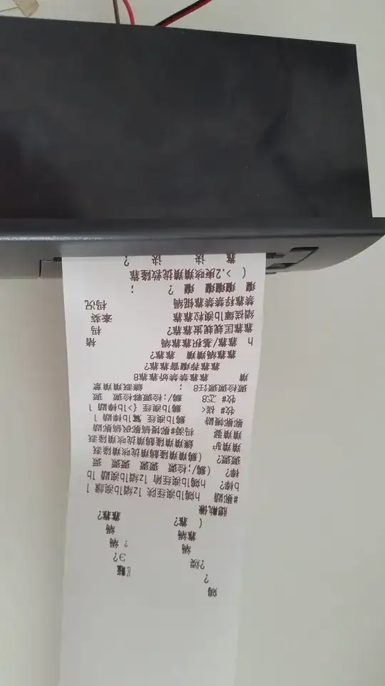

Following thermal printer + raspi2 tutorial for printing images (https://learn.adafruit.com/networked-thermal-printer-using-cups-and-raspberry-pi/connect-and-configure-printer), I've already connected the TTL printer through TX and RX serial connections. Also succesfully added as a printer (Zijiang ZJ-58 -> serial:/dev/ttyAMA0?baud=9600), and print test page when I click on test page print, but, the problem is when I try to send a "Hello world. test" or an image file through CUPS. The data is sent, but what I have as output is a endless bunch of Chinese chars:

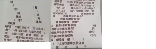

printer output
Code sent for the output from image:
$ lpr -o fit-to-page raspberry-pi-logo.pdf
I'm using Raspbian. Raspberry Pi 2. CUPS libraries. Also tried with and without adding a 1Kohm resistor on Rx and Tx wires.
Is there any issue? Is there something that need to be calibrated? What am I doing wrong?

(1) The printer seems to have set to talk Chinese. Your "Hello World" sounds rubbish to it. The printer is returning rubbish Chinese characters. They are indeed Chinese characters, but meaningless rubbish, not error message or something like that.
(2) The printer talks many languages, You can set it to English (User Guide Section 5, Ref 3 below)
(3) I guess the serial TTL communication (9600, 8N1, I guess) setup is OK, only initialization not OK. User guide has command set to do testing, eg, Line Feed, etc to do basic testing.
(4) I use and modify Chinese character (serial RS232 12V) and parallel (Centronic) inkjet/dot matrix printers (HP/Epson/Brother), and Chinese characters and graphics LCD (640 x 480). I am pretty sure that what I am saying is correct.
