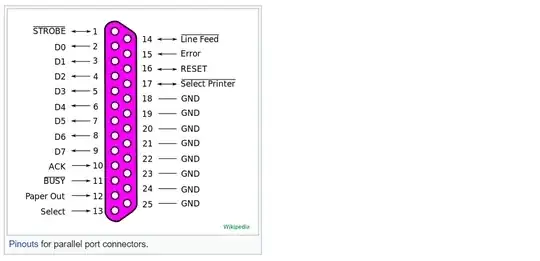

Centronics/Parallel Port Printer Cable - Wikipedia
centronics printer cable

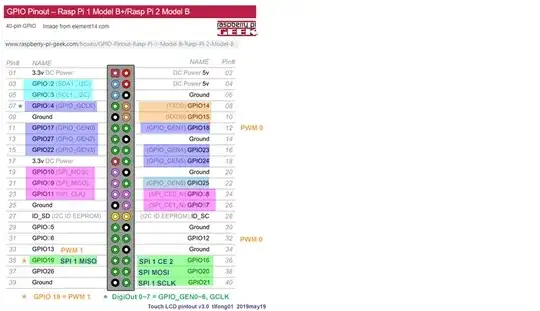

Rpi GPIO Pinout rpi pinout

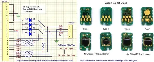

Espon InkJet Chips
epson inkjet chips

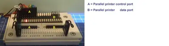

YouTube Video of gpioPinTest program (See Appendix E)
gpioPinlist picture
