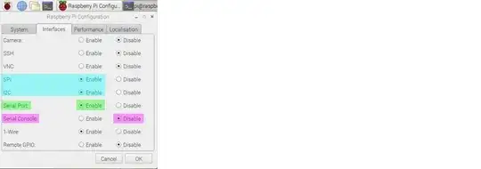

Sometimes the serial setting gets corrupted. Remember to check from time to time that:
  1. Serial port is enabled
  2. Serial console is DISABLED
serial setting
