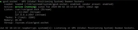

when i check the status of the module it seems to be fine showing the following:
enter image description here However lastly when i check the serial to see if it is receiving any data this occurs

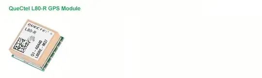

  2. He has a common GPS module QueCtel L80-R

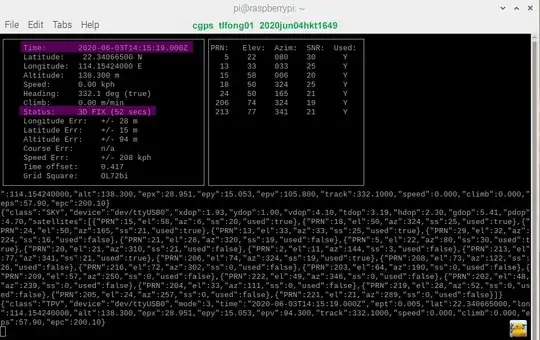

    a. "$ cgps" does not show any GPS data.
    b. "$ cat /dev/ttyUSB0" does not show any serial transmission signals either.

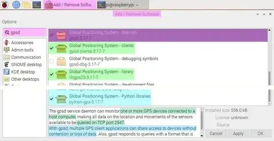

  1. Install the three most basic GPS programs: gpsd, gpsd-client, python-gps, all three programs must be of same version 3.17-7. See Appendix D for more details.

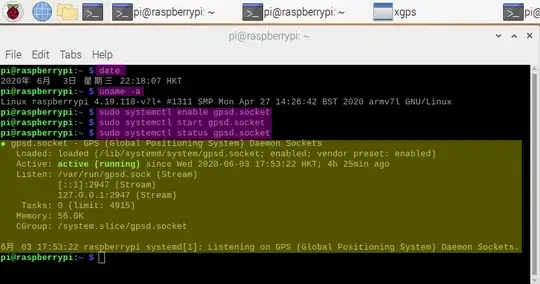

  2. Enable/start/status GPSD, to make sure the software has been installed properly. In case there are installation errors, it is important to remove old installations, or use a fresh SD image to try again. It is easier to do the installation using Desktop GUI. I have tried with Rpi3B+ and Rpi4B, both with raspbian buster. See Part C below for more details.

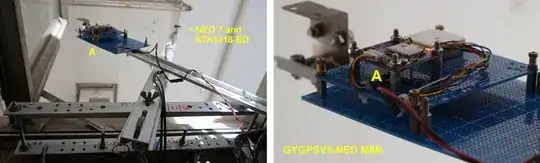

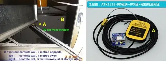

Part A - Setting up the GPS module and trying to get a fix

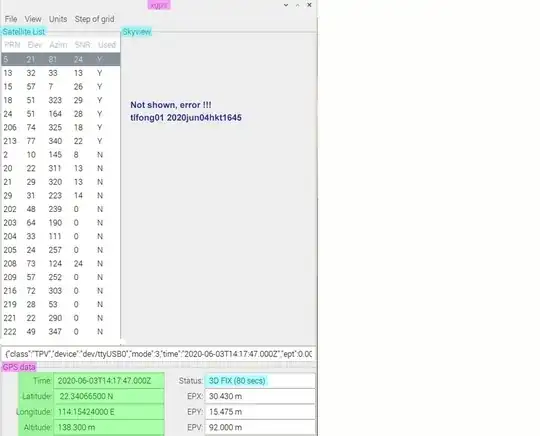

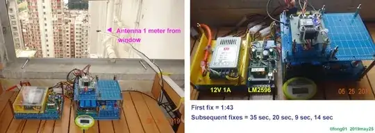

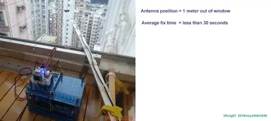

First thing first is to set up the GPS module and try to get a fix (Figures 1 ~ 3).

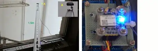

I placed the antenna about 15cm outside the window and powered up. As usual, the first fix takes about 1 to 2 minutes. The subsequent power off power on fixes takes from 15 sec to 45 sec, with an average of 30 seconds. This fixing timing is similar to last time of 2019may. So I quickly concluded that setup and fixing is reliable.
This is the imgur fixing video.
And the photo.
Notes:
  1. When power is on, blue LED is turned on and steady. When there is a fix, blue LED blinks as shown in the above Imgur video.
  2. The serial cable is not connected in this fixing test. Serial cable test is the next step.

Part C - Installing GPSD

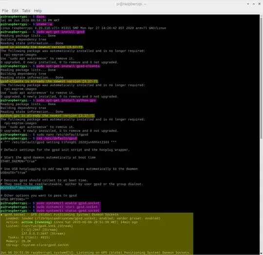

I quickly read the Quectel L80RE GPS Module User Guide and follow the instructions there to install the following:
gpsd, gpsd-clients, and python-gps,
and starting running it. Everything was smooth, except a couple of errors during installation. I could enable, start, status without any problem but cgps does not seem to run properly, such as indicating no fix, though there are actually a fix.
gpsd install
The above installations using CLI terminal commands $sudo apt-get install were not smooth, with a couple of error messages. So I used buster Desktop GUI and installed the similar gpsd and client packages v3.17-7 as shown below:
gpsd and clients installation

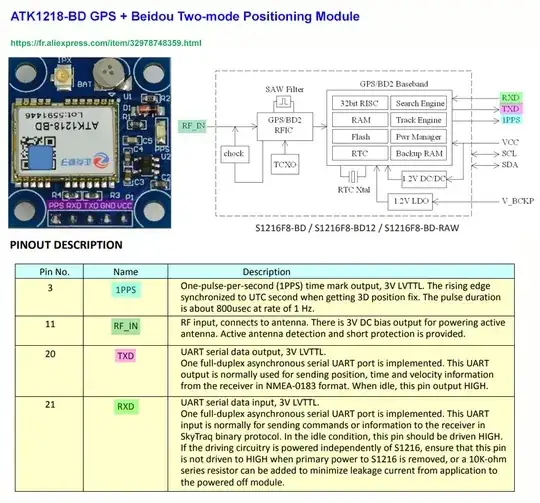

Appendix A - GPS Module Pinout and Block Diagram
gps module pinout

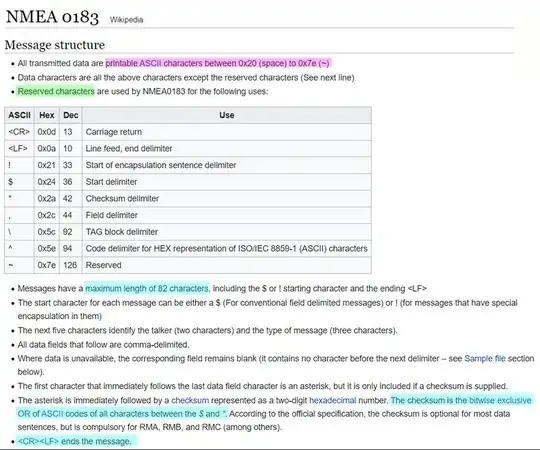

Appendix B - NMEA 0183 Message Format
nmea0183msg 1

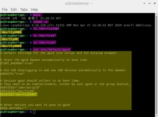

$ dmesg | grep tty [ 0.001609] console [tty1] enabled [ 0.092061] 3f201000.uart: ttyAMA0 at MMIO 0x3f201000 (irq = 87, base_baud = 0) is a PL011 rev2 [ 0.594855] console [ttyAMA0] enabled
ttyS0 = Serial for Raspberry Pi 3, ttyAMA0 = Serial for all other Raspberry Pi 'serial0' is assigned as an alias to either of the above devices. This makes the device a lot easier to remember.
pi@raspberrypi ~ $ ls -l /dev/serial0 lrwxrwxrwx 1 root root 5 Aug 28 12:49 /dev/serial0 -> ttyS0
Install gpsd
$ sudo apt-get update $ sudo apt-get upgrade $ sudo reboot $ sudo apt-get install gpsd-clients gpsd -y $ usdo apt-get install gpsmon
To enable/start/stop/disable/kill gpsd
$ sudo systemctl enable gpsd.socket $ sudo systemctl start gpsd.socket $ sudo systemctl stop gpsd.socket $ sudo systemctl disable gpsd.socket $ sudo killall gpsd
Gpsd config file
$ sudo nano /etc/default/gpsd Look for DEVICES="" and change it to DEVICES="/dev/serial0"

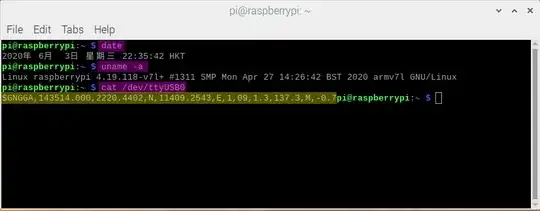

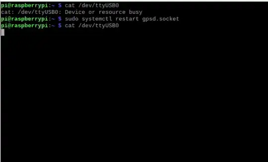

cat /dev/ttyUSB0 will only work if the baud rate is set correctly on both sides of the UART which may or may not be the case. Check the documentation for your module to see if there are any instructions regarding the baud rate settings.
Also, cheap GPS modules are not going to give you any meaningful data until they acquire a fix, and must be tested outside. Do a test outdoors, preferably with a laptop, and wait for at least 12.5 minutes before trying to communicate with the module.
