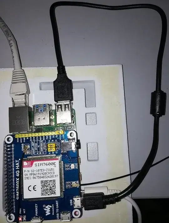

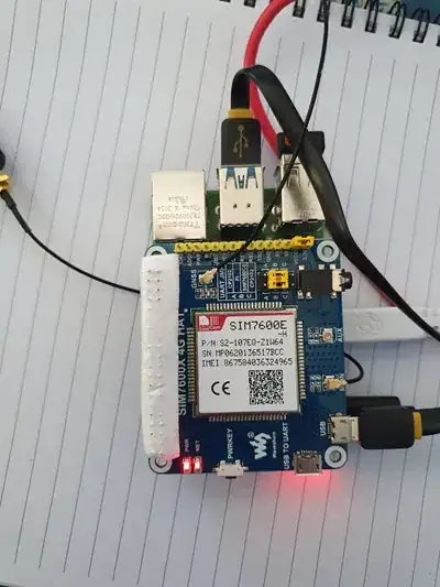

enter image description hereI'm not able to receive GPS data.
The jumpers are placed in the top position (A)
AT commands return the following:

All I see is this:
/dev/ttyUSB2 is True AT+CGPS ERROR AT+CGPS returned: AT+CGPS ERROR
