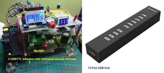

  1. I once tried two USB/TTL adapters on a 4 way switchable USB hub and found no problems I think it is very likely that Rpi can handle 20 USB/UARTs. I saw 10 way USB hubs with each channel switchable, and so it is handy though bulky. You might like to read this post for more details. How many serial ports are on the Pi 3?
