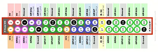

I rather stupidly connected 5 V logic directly (without using a level shifter) to Rx, GPIO 15 (pin 10), of my RPi 2B and now it appears to have stopped functioning.
GPIO for RPi 2B
Could I configure another pin as Rx? Be that via a config file, or setting, or kernel recompile?

There are alternative usable pins on the compute module. There are no alternative hardware pins on the other Pis.
I have bit banged serial using my pigpio library. Anything under 19k2 baud appears rock solid. Anything faster and you would need error checking.
Bit banging the input side is trivial.
sudo pigpiod # start the pigpio daemon
pigs slro 23 19200 8 # open GPIO 23 for 8-bit bytes at 19k2 baud
pigs slr 23 200 # read up to 200 bytes from GPIO 23
The output side is a bit more complicated and uses pigpio waves.

connected 5 V logic directly to Rx now it appears to have stopped functioning.
You can use USB UART/TTL cables. Then you can have as many UARTs as you have USB/TTL cables.
