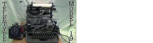

Well, "tty", or "TeleTYpe", like TeleVision, in the stone age, the tele-typewriter ("typewriter" in turn, is ancient, belonging to my grandmother days) is just a "terminal" to which user inputs something, then system outputs something (sort of GIGO - garbage in, garbage out! :)
teletype
