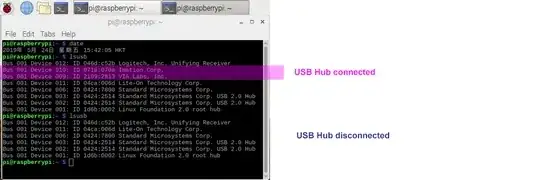

You can also using linux terminal command "lsusb" to make sure if USB hub is detected.
usb hub detection
