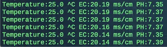

Screenshot of output
You can adapt to your project and works properly.

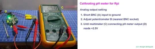

Q1. How to adjust offset?
A1. Following Part1 Section 1,
(1) Power supply 5V to module,
(2) Do the 3 offset calibrating steps until your multi-meter read about 2.5V.
Notes:
(a) For offset calibration, you don't use any liquid sample. You just short the BNC plug input (centre) to ground (outside sleeve), using to clips, so that the input to pH sensor is zero.
Part 1 - Calibration Procedure
1. Analog output offset procedure
Offsetting meter analog output of 0.0V to + 2.5V for compatibility with ADC such MCP3008, MCP3208 etc. Cheap pH meters are almost always designed for Arduino which has an analog pin A0 to convert analog signal to digital. Rpi, sadly does not have any analog pin, so must use an external ADC moduel. More about this later.)
ph meter
offset procedure

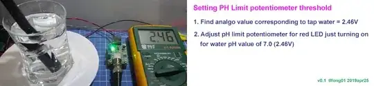

2. pH limit potentiometer adjustment procedure
Set 2.46V which corresponds to the pH value of tap water as threshold voltage, by adjusting the limit potentiometer so that the red LED just turns on.
ph limit setup
Self/Auto Calibration Procedure

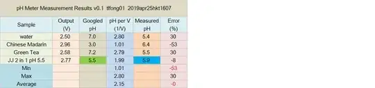

So the US10 cheap meter gives 2.46V for water. That is amazing, considering that I was too lazy to clean the glass, which for sure has some faint whisky traces left. My offset to the pH meter ADC is +2.5V, implying that water should read +2.50V. Again I am only using home tap water. Perhaps whisky and heavy metal traces in the tap water balances out. :)
Now that I think I should test at the other extremes, very acid and very basic. I have googled the following pH value charat, and see if I can find some more things to test/calibrate.
ph values chart

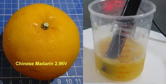

I just finished lunch. Before eating the desert Chinese mandarin dessert, I toodk a photo, and checked it pH.
chinese madarin

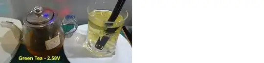

And green tea pH again.
green test 2.58v

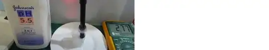

Now there is the pH of something that I really want to know, the body wash I am suing every day.
I found the analog voltage. Now I need to calcule the pH value.
jj 2 in 1 pH5.5

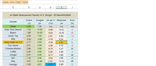

ph results table

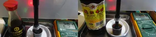

Now soy sauce and vinegar

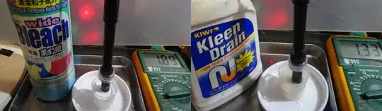

And finally, very acidic bleach and drain pipe cleaner!
bleach and drian pipe cleaner

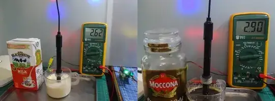

I am making morning coffee with milk, and a selfie!
coffee with milk

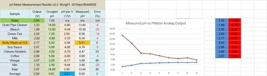

I updated the Excel worksheet with coffee and tea. Now the average pH/V is recursively self calibrating, meaning that more measurements added, more "accurate" is the average pH/V.
What I found too good to be true is that the measured pH value of the JJ body wash claiming pH5.5 is 5.51!
ph table

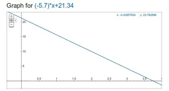

Now I have drawn the graph to get the values for the Rpi python program to calculate the pH values.
ph worksheet

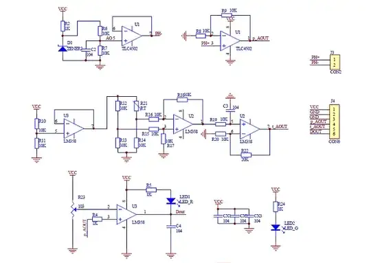

pH meter temperature compensation calibration procedure
I read more references and found a problem. That is Arduino has ADC pins to read the pHmeter's analog signals Po and To, but Rpi has no built in ADC pins, and must use external ADC to do the conversion.
ph meter pinout

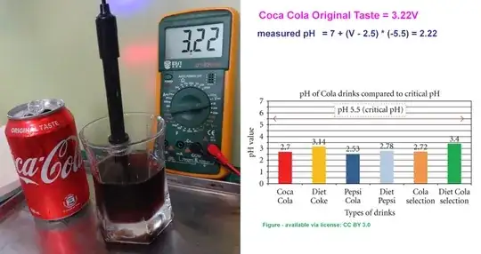

Coca Cola is pH 2.2
coca cola ph

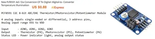

PCF8591 ADC for pH meter
Now I am thinking of using PCF8591 to do ADC of pH meter for Rpi to read.
pcf8591 module

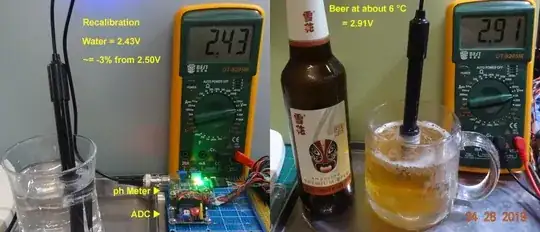

Now I have moved both the ph meter and PCF5891 ADC module to a protoboard. This time I did a recalibration using tap water. I found the reading is off by about 3%. The PCF8591 8bit ADC is 1/256 ~= 4%. So I think it is OK for now as a feasibility study to use a 8-bit ADC. Later I think I should replace the 8-bit to a 12/16 or even 24 bit ADC, if I am measuring the pH values not in 1~14 (0V to 5V), but say for soft drinks, in a narrow voltage range of 1 to 2 volts.
Anyway, the ADC is ready to start testing. In other words,
Rpi python pH value measurement programming only starts now! :)
ph meter and adc

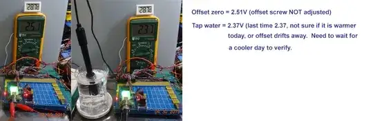

Update 2019apr29hkt2308
I forgot to do temperature calibration. I used a heat gun to do a rough check. I found that at room temperature the output is a steady 4.2V. The reading goes as low as 2V when I used the heat gun to increase the temperature of the NTC thermistor. The reading goes low very fast, and recovers to normal only a couple of minutes after I removed the heat. So I now know it is around 4.2V at room temperature and goes low to 2.0V when very warm. The digital out is 0.8V and the red LED is on. Anyway, I will not be using the alarm warning red light for now.
So now I really start the ADC python programming.
But I need to make sure if the meter offset has not drifted away. I found ph 7 voltage is 2.51V, not drifted at all, but tap water measured 2.37, offset 5.2%. Perhaps the probe is contaminated, because I have been too lazy to rinse it often, ...
water ph

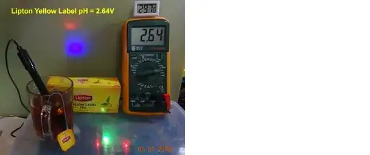

Chinese Tea = 2.58 vs Ceylon Tea 2.64
Voltage difference = 2.58 - 2.64 = 0.06V
Percentage difference = 0.06V
0.06V / 5V (input range) = 1.2% 1 / 256 (8-bit) = 0.4%

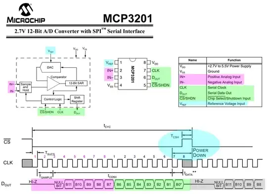

So I am thinking of using another ADC. I am considering MCP3008 and MCP3201. SPI MCP3201 seems appropriate for this pH meter project, which needs only one channel, thus the Rpi python SPI program should be easy to write and debug.
MCP3201 SPI 8-bit ADC to convert the pH meter analog signal
Comparing MCP3201 with PCF8591 Record
MCP3201 12-bit SPI 2.7V - 5.5V 100ksps max
PCF8591 Datasheet - NXP
AliExpress PCF8591 AD/DA Converter Module Analog To Digital Conversion temperature illumination For Arduino - US$1.37
lipton tea

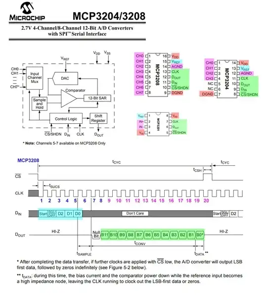

Programming MCP3201 to convert pH meter output
MCP3201 seems even easier than MCP3008, because it has only one differential channel, no need to mess around with which channel single ended, which channel differential, and should idle channel pull up to reduce noise etc.
mcp0321
Replacing MCP3201 by MCP3208
I found a problem. I forgot that I actually need to calibrate or convert two analog signals: (1) pH value Po and (2) NTC 103 temperature sensor analog signals. I thought about using MCP3204 the 4 channel version. But MCP3204 and MCP3208 are almost identical in architecture, the only difference is number of channels. So the python program is more or less the same. So I decided to use MCP3208.
mcp3208 summary
Now it is time to start writing the python program. I am thinking of writing 3 big functions:
  1. Write command to MCP3208 ADC
  2. Read results from MCP3208 ADC
  3. Convert binary data to decimal
  4. Try to guess if it is soft drink, coke or pepsi, or if fruit, possbile orange or mandarin, etc,
Update 2019may03hkt1056 - MCP3208 Programming Notes
Now I have enhanced the basic SPI loop back and repeat send with the following functions to make it easier to interface with MCP3008/MCP3201/MCP3208
  1. Added loopback 1, 2, and 3 bytes. Because MCP3008/MCP3208 works by writing and reading two bytes. Other ADC with 16/24 bits resolution work with three bytes write read. So it is important to make sure write/reading 2/3 bytes are OK.
  2. Added repeat write functions for easier scope display. This is important to make sure that the waveforms are not noise interferenced or distorted at high frequencies. For now only 100kHz is tested. A sample scope screen capture is show below, and looking OK.
mcp3208 repeat send
MCP3208 Program Listing
The program should go many debugging and revisions, therefore not to do too frequent updating is this post, a Penzu programming diary is given here. The link will keep the same until next programming milestone. Otherwise the same link will find new program versions updated int eh PenZu diary. Now is version 09.
mcp3208 SPI ADT Test Program Version 09 - tlfong01 2019may03hkt1108

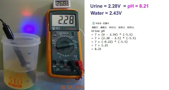

I checked my urine and found its pH about 8. I googled and concluded that it is alkaline. I also read the following article to know more.
What is the normal pH range for urine? - Rachel Nall 2018dec11, Reviewed by Shilpa Amin MD, CAQ, FAAFP
According to the American Association for Clinical Chemistry, the average value for urine pH is 6.0, but it can range from 4.5 to 8.0. Urine under 5.0 is acidic, and urine higher than 8.0 is alkaline, or basic. Different laboratories may have different ranges for "normal" pH levels.

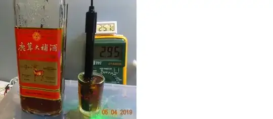

deer wine pH
Now Chinese deer herb wine voltage output = 2.95V
So pH value = 7 + (2.95 - 2.5) * -5.5 = 4.5
And urine pH measurements
urine pH value

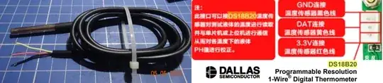

Using DS18B20 to measure the temperature of liquid to refine calibration
When translating the OP's pH meters manuals, I found the DS18B20 is used to measure the liquid temperature, so to adjust the calibration values. So I am now checking out how DS18B20 can be used.
DS18b20

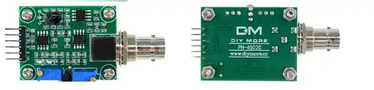

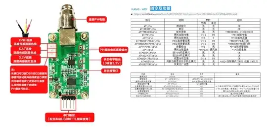

Part 2 - Chinese to English Manual Translation and Suggestion for Newbies
Well, give me the link of the Chinese manual, I can translate it into broken English. :)
ph4502c
Do you mean the AT instruction set? Or the hardware setup? I guess they are common to all the real and fake boards. I can do the translation if that is what you need.
The basic Hello test is universal. You say "AT\r\n", and the Ph Board will return "OK". The general commands are also universal:
Reset, Current Ph value, Temperature, Threshold, Factory default setting, Current operation mode, ...
ph at code
If you wish to translate the names of the pins. Here is one for the J3, J4 pinouts.
ph_tester_pinout
You may have already found the location of DS18B20 temperature sensor pin. This is a standard device, so you don't need to read their instruction.

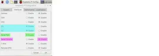

One final reminder to USB CH340 newbies: Remember to disable Serial Console at the Rpi Config Menu:
serial cable disable

Graph of the measured voltage and pH equation
Graph of the measured voltage and pH equation. y= -5.70 * x + 21.34
Using the powders with pH 4.01 and pH 6.86 we obtain the voltages on the pin Po 3.04V and 2.54V respectively. The sensor is linear so by taking two points we can deduce the equation to convert the measured voltage to pH. The general formula would be y = mx + b, so we have to calculate m and b since x would be the voltage and y the pH. The result is y = -5.70x + 21.34.
Connection with Arduino
To connect with Arduino we will need an analog input (A0), power (5V) and two GND that actually in the sensor circuit are separated but we can use the same.
Code
The code consists of taking 10 samples of the analogue input A0, ordering them and discarding the highest and the lowest and calculating the mean with the six remaining samples by converting this value to voltage in the variable pHVol, then using the equation that we have calculated with the pH reference values we convert pHVol to pHValue and send it to the serial port to see it in the serial monitor.
