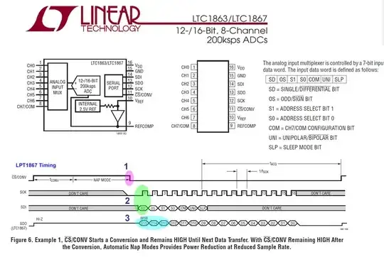

Now that we have checked that the Rpi SPI can do loopback, we can connect the CLK, MOSI, MISO wires to LPT1867 and talk to it.
Earlier I recommended you to read the post about how to red the scary timing diagram of MCP3008. Actually there are only three big steps: (1) write byte to tell ADC which channel, single or differential, etc. (For LPT1867, you make also need to wake it up. But the basic pattern is more or less the same. ), (2) Read the binary results at the same time (yes, for SPI, you write and read at the same time) (3) Convert binary result to decimal for human eyes to read. And day is done.
Now you need to compare your LPT1867 with the simpler MCP3008, to know the difference.
lpt1867 summary

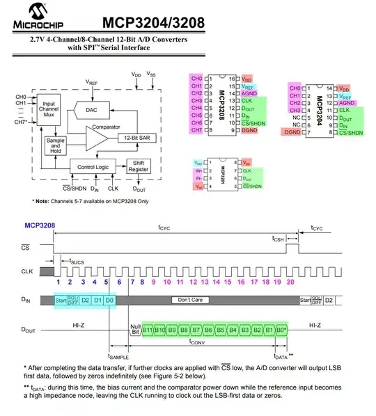

LPT1867 is similar to MCP3208, though more complicated, eg, 16-bit resolution compared to MCP3208's 12 bit, polarity selection, sleep mode bit etc. The start and read ADC result is basically the same. You may like check out MCP3208 timing diagram below. And you can google for Rp python MCP3208 programs and 'translate' it to LPT1867.

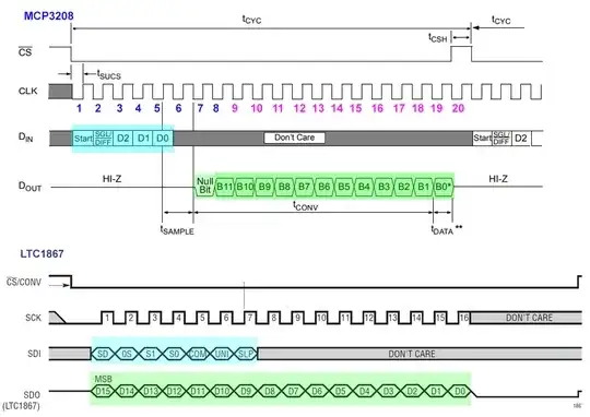

Now I am trying to do one MCP3208 ADC by doing the following:
  1. Write 3 bytes to MCP3208, first byte is the command byte for MCP3208, second and third byte are dummy bytes.
  2. At the same time, read 3 bytes from MCP3208. These read 3 bytes contains the raw data. I need to extract the raw data and translate it into decimal values.
The LPT1867 seems similar. You also write 3 bytes and read back 3 bytes which contains raw data results.
ltc1867 vs mcp3208
