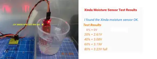

Some months ago I played with a couple of moisture sensor / level detectors. Below is an example.
water level sensor Water Level Detection Discussion - Rpi StackExchnge

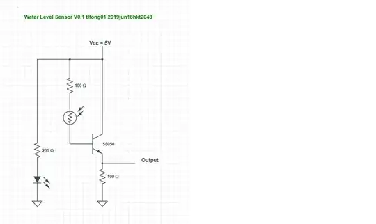

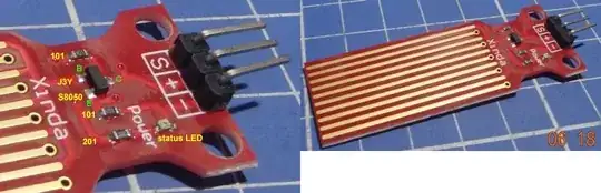

I very surprisingly found that all the five samples from different manufacturers have the same resistance of 0.5 ohms for each of the two resistive "legs".
level sensor resistance

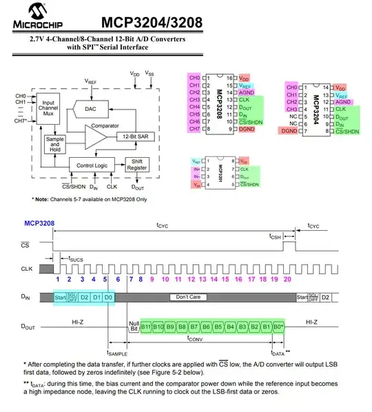

Anyway, I think I can try to use an ADC that can measure my sensor's 0.5 ohm range, and also the OP's 20~200 ohm range. I am thinking of starting with the cheapest, and lowest resolution ADC/DAC PCF8591. If its low resolution is not enough for 0.5 ohm range, then perhaps I will try others, such as MCP3x02/04/08. The good thing about PCF8591 is that there is cheapy module available, and programming easy, so is newbie friendly. On the other hand, MCP3x02/04/08 is big family of ADCs, from 12 bits to 18 bits (MCP3404)
PCF8592
mcp3x020408
level_sensor 1
level sensor 2
