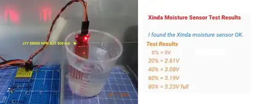

I found that the Xinda water level detector uses the very common NPN BJT SS8050. Usually the a BJT is biased for a fixed voltage, say, 5V for Arduino. If you supply power Vcc = 3V3, then the BJT might not work properly, or intermittently marginal. On the other hand, CMOS FET circuit usually works from 3V to 5V. So my conclusion is that
this water level should use 5V power supply 5V.
Some months ago I tested the detector with the following results.
detector results
The output is analog from 0V to 3V, so is good if you want to measure rain water level. But then you need an ADC.

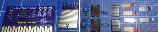

But if your application is not water level detection, but also soil moisture sensing, then there are many more digital and analog devices to choose, but more expensive. The one in the reference using the OP Amp MCP606 as a comparator, gives digital output for easy digital interface.

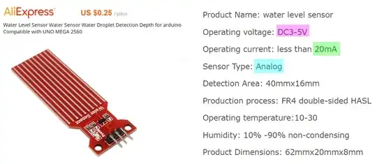

water level sensor spec
