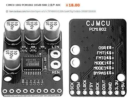

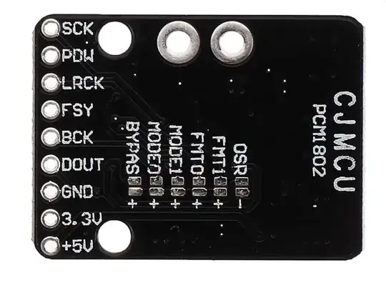

CJMCU PCM1082 ADC Module has SCK,PDW,LRCK,FSY,BCK,DOUT,GND,3.3V,5V pins also with LIN and RIN.
Connecting the 3.3,5 and GND are pretty obvious, but for the other ones, I read the PCM1802 IC datasheet that is used in the module, And I found out that:
  • SCK is System clock input
  • PDW is Power-down control which is active low.
  • LRCK is Sampling clock input and output
  • FSY is Frame synchronous clock input and output
  • BCK is Bit clock input and output
And DOUT is simply serial output.

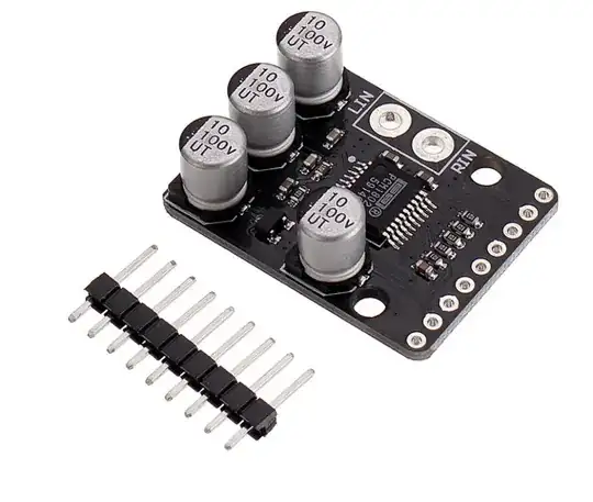

You can see the pictures of ADC module and MAX4466 microphone module below:
CJMCU PCM1082 ADC
CJMCU PCM1082 ADC

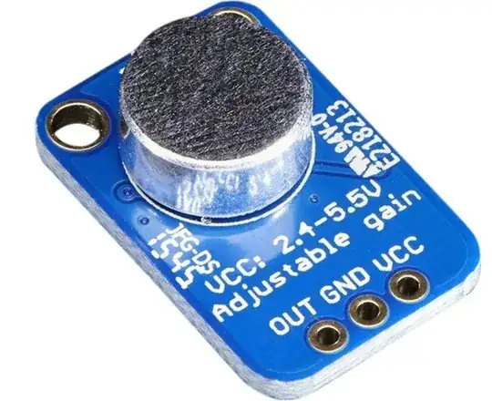

MAX4466

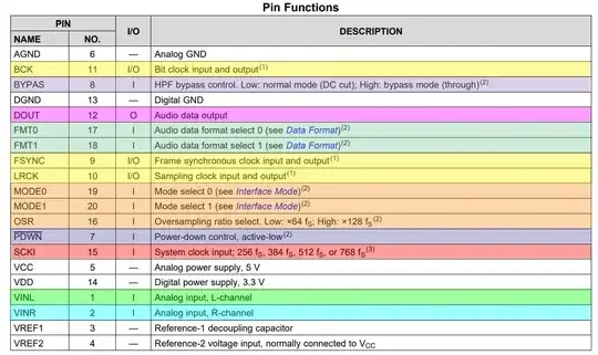

(1) How come MCP3008 has only one clock, but PCM1802 has three clocks?

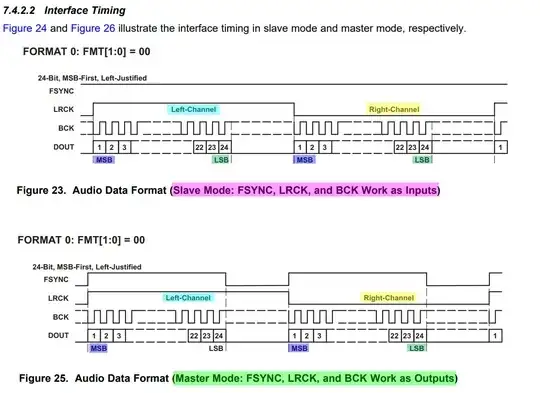

Well, [In slave mode] BCK, LRCK, and FSYNC are input pins, as summarized below (See Datasheet Section 7.4.4 Slave Mode for more details):
(a) FSYNC enables the BCK signal, and the device can shift out the
converted data while FSYNC is HIGH.
(b) The delay of FSYNC from the LRCK transition must be within 16 BCKs
for the 64-fS BCK format and within 12 BCKs for the 48-fS BCK format.
(2) How can Rpi config and control the PCM1802?
Ah, you can use Rpi GPIO pins to do configuration and control, as summarized below:
(a) BCK, LRCK, and FSYNC clock signals control output timing (Section 7.4.2.2, also Appendix E below.)

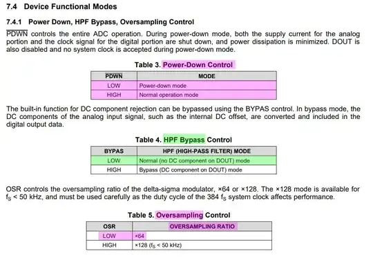

(b) PDWN,  controls the entire ADC operation (there is no powerup signal.  In other words it is a power up/power down or enable/disable signal
(c) BYPAS, bypasses DC component rejection
(d) OSR, sets over sampling rate ratio of the delta-sigma modulator, ×64 or ×128
(e) FMT1 and FMT0, select one of four audio data formats in both master and slave modes.

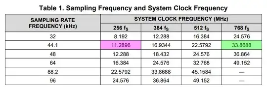

7.3.3 System Clock
The PCM1802 supports 256 fS, 384 fS, 512 fS, and 768 fS as the system clock, where fS is the audio sampling frequency. The system clock must be supplied on SCKI.
The PCM1802 has a system clock detection circuit which automatically senses if the system clock is operating at 256 fS, 384 fS, 512 fS, or 768 fS in slave mode.
In master mode, the system clock frequency must be selected by MODE0 and MODE1, and 768 fS is not available. For system clock inputs of 384 fS, 512 fS, and 768 fS, the
system clock is divided to 256 fS automatically, and the 256 fS clock operates the delta-sigma modulator and the digital filter.
I searched my jun box and found two clock modules 10.24MHz and 32.768MHz which should be good, according to the following table:
sys clock and sampling frequency
That is the system clock detection circuit when PCM1802 is in slave mode should find the clocks are for fs ~= 44.1kHz sampling frequency for 256*fs and 768*fs. I guess PCM1802 should be forgiving enough to tolerate 1~2 MHz deviation in the 10MHz to 33MHz range. I found AliExpress selling crystal oscillator modules at exactly 33.8688MHz (Ref 11). But I think my not so exact frequency module should work OK.
Microphone Amplifier Setup
I have also order the MAX9814 mic amplifier (Ref 12). This model has a 40/50/60dB amplification gain hardware selection pin, so should be good for PCM1802 to handle.

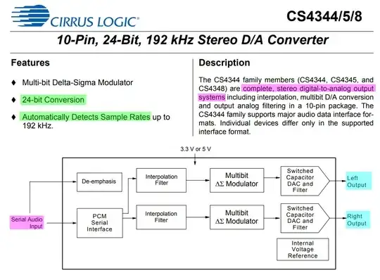

cd4344 DAC module

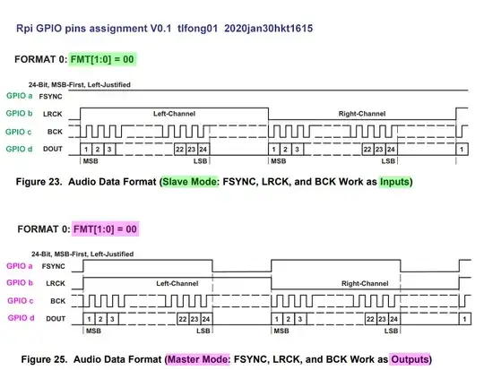

PWRDWN = GPIO (LOW = stop conversion, HIGH = start conversion) BYPASS = Hard wired (LOW = High pass filter no DC component) ORD = Hard wired (LOW = over sampling rate x64)
pwrdwn, bypass, and odr pins

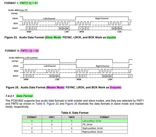

Data format = Hard wired (LOW, LOW, 00 = 24 bit left justified.
data formatting

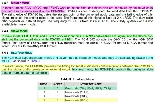

Master/Slave Mode = GPIO (LOW, LOW, 00 = slave mode, HIGH. HIGH, 11 = master mode 256 fs
Question: Can we save one GPIO pin by connecting together Mode1, Mode0 pins and use one GPIO pin to set both pins?
master/slave mode
Rpi GPIO pins assignment V0.1
There are two questions:
  1. Do we need to use any GPIO output pin as clock pin BCK? Or just use an external clock to free run, or enable/disable by GPIO. If yes, is Rpi pin fast enough?
  2. D0 we need to use any GPIO input pin to read DOUT signal? If yes, is Rpi pin fast enough?
pin assignment

Now I need to do calculation of the system clock, sampling rates, and most importantly BCK, bit clock which I am a bit confused if it is automatically generated by PCM1802, and NOT provided by a Rpi GPIO clock pin (GPIO04, GPCLK0).

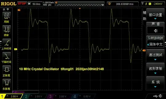

I first checked out if the 10.24MHz crystal oscillator I found in the junk box is still working. It does, but over/undershoots by 2V, and also ringing. I guess it still works. But I need to check out if PCM1802 need a 3V3 clock or not.
crystal clock 10MHz
I read the datasheet and was happy to find that the absolute maximum of system clock SCKI is 6.5V, so I don't need to do any level shifting or use Vcc = 3V3.
Now let calculate the BCK, Bit Clock. If I use crystal clock 10.24MHz, then hopefully PCM1802 in slave mode would detect that 256 * fs is used. So sampling rate should be a bit smaller than 44.1kHz. Now 11.2896MHz / 256 gives 44.1kHz check: sample rate 11.2896M / 256 = (11.2896 x 1000) / 256 k = 44.1kHz). So far so good.
Now
(1) 44.1kHz sample rate means one sample period = 1 / 44.1k = 1 / 44.1 = (1000 /44.1) nS = 22.68 nS
(2) Then if 44.1kHz sample period is 24 bit x 2 48 bits, then Bit clock BCK should be 44.1 * 48 == 2.2 MHz (Not verified; my calculation is always dodgy).
(3) Above calculation is for master mode only. I am too lazy to do the calculation for slave mode, when Rpi GPIO should output LRCLK (Left/Right channel clock?) = 44.1kHz * 2 = 88.2kHz, or == 22.68 nS.
Perhaps the OP should do the dirty and messy calculation work for me!

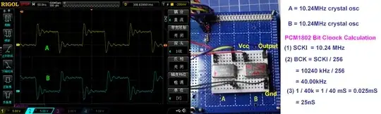

PCM1802 System clock SKI and Bit Clock BCK Calculation for 10.24Mhz Crystal Oscillator.
I worried that the crystal oscillation output might be a bit too dirty for PCM1802. So I searched my junk box for another module to verify and cross calibrate. I was happy to find that both modules look identical. So I can now sleep well and move on to perhaps drawing a schematic and start PCM1802 Rpi4B buster (release 2019sep26) Thonny Python 3.7.3 programming.
pcm1802 clock timing
Drawing the schematic for Rpi GPIO interfacing CJMCU PCM1802
cjmcu pcm1802

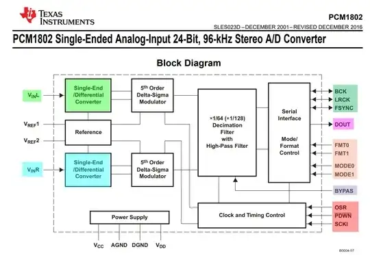

Appendix A - PCM1802 Block Diagram
block diagram
Appendix B - PCM1802 Pinout
pcm1802 pintout
Appendix C - PCM1802 Module Features
pcm1802 module features

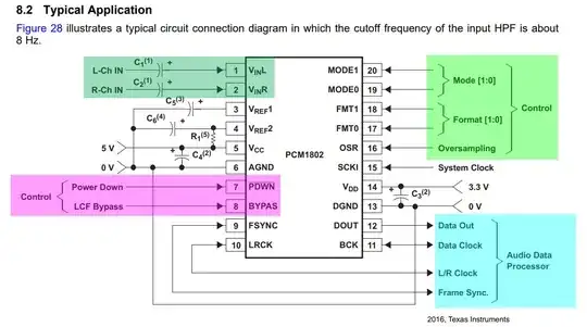

Appendix D - PCM1802 Application Example
pcm1802 application example

7.4.1 Power Down, HPF Bypass, Oversampling Control
PDWN controls the entire ADC operation. During power-down mode, both the supply current for the analog portion and the clock signal for the digital portion are shut down, and power dissipation is minimized. DOUT is also disabled and no system clock is accepted during power-down mode.
BYPAS - the built-in function for DC component rejection can be bypassed using the BYPAS control. In bypass mode, the DC components of the analog input signal, such as the internal DC offset, are converted and included in the digital output data.
OSR controls the oversampling ratio of the delta-sigma modulator, ×64 or ×128.
7.4.2 Serial Audio Data Interface The PCM1802 interfaces with the audio system through BCK, LRCK, FSYNC, and DOUT.
7.4.2.1 Data Format The PCM1802 supports four audio data formats in both master and slave modes, and they are selected by FMT1 and FMT0.
7.4.2.3 Synchronization With Digital Audio System In slave mode, the PCM1802 operates under LRCK, synchronized with system clock SCKI. The PCM1802 does not require a specific phase relationship between LRCK and SCKI, but does require the synchronization of LRCK and SCKI.
7.4.3 Master Mode
In master mode, BCK, LRCK, and FSYNC work as output pins, and these pins are controlled by timing which is generated in the clock circuit of the PCM1802. FSYNC is used to designate the valid data from the PCM1802.
The rising edge of FSYNC indicates the starting point of the converted audio data and the falling edge of this signal indicates the ending point of the data. The frequency of this signal is fixed at 2 × LRCK. The duty cycle ratio depends on data bit length. The frequency of BCK is fixed at 64 × LRCK.
7.4.4 Slave Mode
In slave mode, BCK, LRCK, and FSYNC work as input pins. FSYNC enables the BCK signal, and the device can shift out the converted data while FSYNC is HIGH. The PCM1802 accepts the 64-fS BCK or the 48-fS BCK format. The delay of FSYNC from the LRCK transition must be within 16 BCKs for the 64-fS BCK format and within 12 BCKs for the 48-fS BCK format.
7.4.5 Interface Mode The PCM1802 supports master mode and slave mode as interface modes, and they are selected by MODE1 and MODE0 as shown in Table 9.
8.2.2.1 Control Pins
The FMT, MODE, OSR, and BYPASS control pins are controlled by tying up to VDD, down to GND, or driven with GPIO from the DSP or audio processor.
8.2.2.2 DSP or Audio Processor
In this application (Appendix D above) a DSP or audio processor acts as the audio master, and the PCM1802 acts as the audio slave. This means the DSP or audio processor must be able to output audio clocks that the PCM1802 can use to process audio signals.

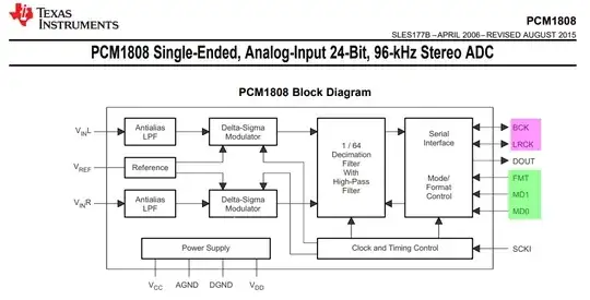

Appendix F - PCM1808 Block Diagram
Clarification - PCM1802 vs PCM1808
I mixed up PCM1802 with the less powerful PCM1808 (without the FSYNC signal pin) in the discussion and references. My apologies.
