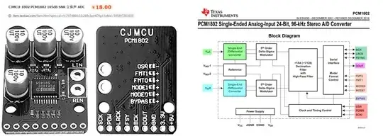

For real time streaming audio hobbyists, I would recommend dirt cheap PCM1802 (Ref 1).

(1) How to use Rpi python to control PCM1802 24-bit HiFi stereo ADC and MAX4466 microphone amplifier
Appendices
(A) PCM1802 Features and Block Diagram
pcm1802
