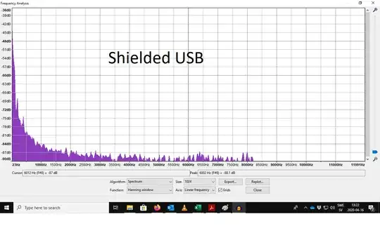

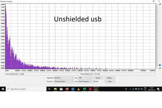

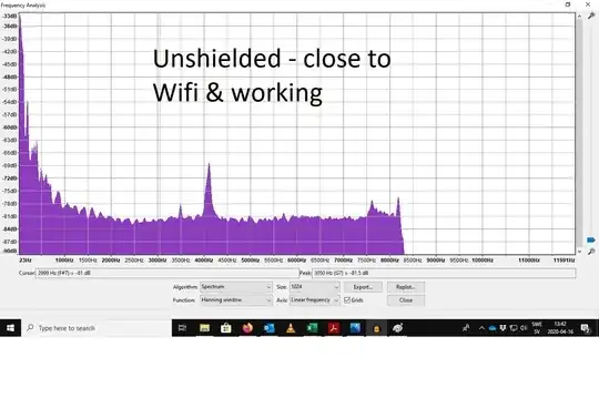

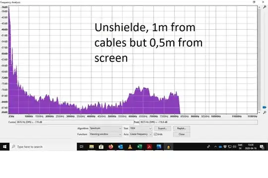

  1. Magnetic / Radio interference (EMI / RFI). This is caused by cables acting like recieving antennas and pick up radio frequencies or magnetic induction from nearby electrical cables and radio sources (wifi, fans in computers, TVs & screens, even the PI's own wifi). This is typically low frequency buzzing (50-150 HZ), usually associated with powercables, and higher frequency clicking and ticking from other electric equipment like wifi or electrical motors. The best cure I have found so far is to shield the entire soundcard and microphone with tin foil and ground it to the USB ground (the USB contact shield). As seen in picture below it reduces the lower frequencies with about 10db, the most marked reduction is below 1500 hz. I have also found it reduces interference by wifi.
(please note that the scale is different on the two pictures, so it looks like the unshielded has less noise but in fact it is more ) enter image description here enter image description here

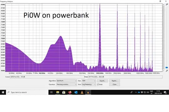

  3. The PSU and Pi itself. Once you have removed the outside sources of noise with shielding, what remains is probably coming from the PI itself. Poor power supplies seem to be the main cause here but I have yet to find something that is working. Even official PSUs seem to cause noise. Ferrite beads will help some but they usually capture high frequency noise. The highest peaks of noise is below 1000 Hz.

Add: Here are two pictures of an unshielded USB card and when it is less than 50cm from a computer screen and a wifi router (again, note difference in scale). Both sounds like ticking noise. enter image description hereenter image description here

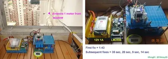

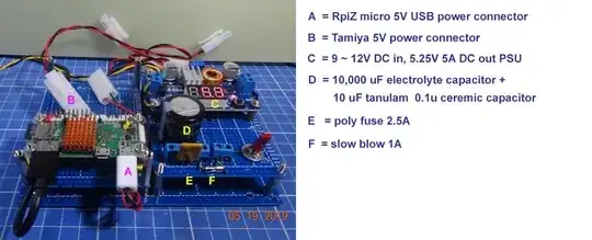

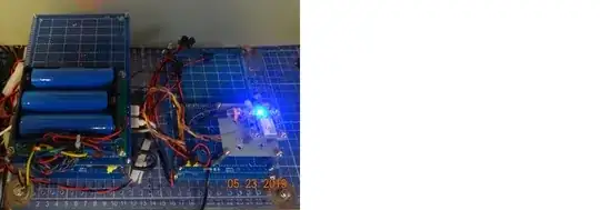

I appreciate you experiment results very much. I also have noise problems in my projects. (1) I often use Lipo power banks (18650 x 3) 12VDC and step it down to 5V for Rpi and other circuits. (2) I even avoid using switching power supplies (LM2596/LM2941) and use series regulators (7805) and LDOs, (3) I use huge bypass capacitor (electrolytelyte) 10,00 uF), 0.1~1uF tanlum/cermic caps. (4) I also use dedicated/separate PSUs for Rpi and power amps,
(5) Grounding is also very important, I separate my grounds into (a) power ground, (b) logic ground, and (c) audio signal ground, and of course shielded or double shielded AV cables. I even dedicate the Rpi's several ground pins into groups, for I2C/SPI/UART/GPIO (audio) etc. Of course I need to use "ground stubs" later. For also signals Audio or I2C etc, I have separate ground lines going with them,
(6) For power amps, I sometimes use differential input D type power amp. (7) I also have digital low/band pass filters (for my EEG/ECG/GPS etc) to try to reduce noise. (8) I use UGreen USB sound cards (OK, they are not very HiFi, but cheap, with button selection of raw/music/gaming band widths. (9) I also try dynamic/moving coil (Sony grade) and cheap pizo microphones.
