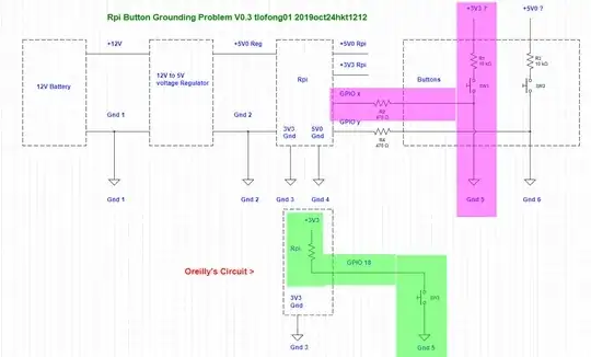

ground3

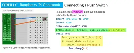

Let us first look at Oreilly tutorial's push button circuit.
orielly button 1
Then compare Oreilly circuit (green part) with the above circuit (pink part). The OP's question now boils down to
Should Button Ground 5 connected Rpi Ground 3 or Voltage Regulator Ground 1?
oreilly 2

(1) Rpi Push button tutorial - Oreilly
