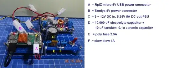

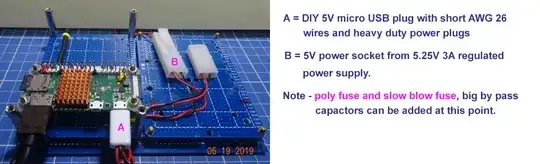

Yes, RpiZero does not have poly fuse protection. So I added poly fuse and also slow blow fuse myself.

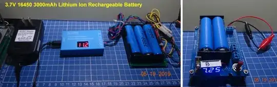

I prefer to apply power at the micro USB connector, because it is easy to do maintenance work like measuring voltage levels, modifying PSU with UPS etc. Applying power to the 40 pin Power/GPIO DuPont male plug is bit risky, because careless shorting 5V, 3V3 power pins to ground or GPIO pins might damage something.
