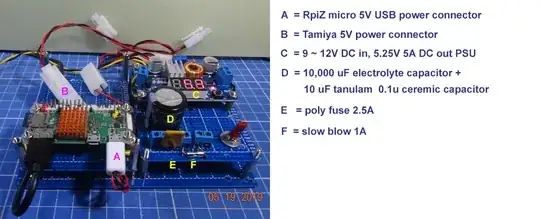

Well, all these years I have been using a "12VDC source" to INDIRECTLY power the Rpi. I emphasize the word "INDIRECTLY", because of course I do not directly feed 12V to Rpi. I use a fixed or adjustable step down regulator to convert 12VDC to around 5.25V which is then used to power Rpi or RpiZ.
The 12V DC PSU, power supply units I have been using including:
  1. AC200V in 12VDC 1A/2A/5A/10A out switching power supply
  2. LiPo power bank of 3 cells = 3.7 x 3 ~= 11V ~= 12VDC
  3. 12V lead acid battery
I have no experience in using 12V car battery or solar power battery. But I am pretty sure that any 12VDC 1A/2A/5A PSU can step down to 5V or 5.25V and power Rpi/RpiZ without any problem.
One thing you might consider is to use a fuse to over current protect RpiZ which does not have built in over current protection. You might like to read the following post for more details.
Powering Rpi Zero with external over current protection
rpiz psu
