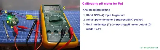

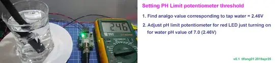

  1. DIY PH-4502C pH Sensor has an analog output. So you can use a multimeter to read the analog values and use a voltage to pH values table to find the pH value. You can also use Rpi to interface an ADC eg, MCP3008, and convert the ADC results to pH values.
  2. I am summarizing some of my findings below.
1. Setting up summary

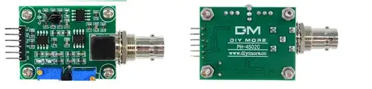

4502c module
measure
example reading
conversion table

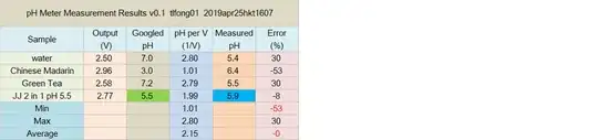

Appendix A - Experiment Results
pH table

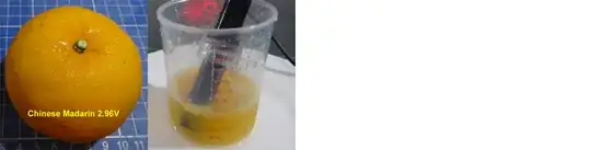

orange

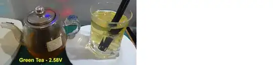

tea
