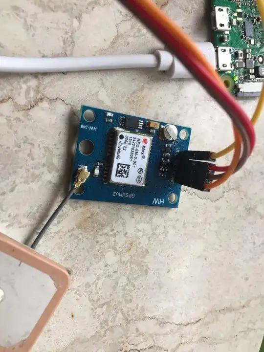

Hi i'm tryng to change the update rate of my gps tracker(neo 6m ublok) i know the byte that i need to send are 0xB5,0x62,0x06,0x08,0x06,0x00,0xC8,0x00,0x01,0x00,0x01,0x00,0xDE,0x6A
i've tried echo -e "\xB5\x62\x06\x08\x06\x00\xC8\x00\x01\x00\x01\x00\xDE\x6A" > /dev/ttyAMA0
and with the service stopped i also tryed with a program in c

but nothig change the navigation update rate of the device
all of the byte code came from the manual of the device

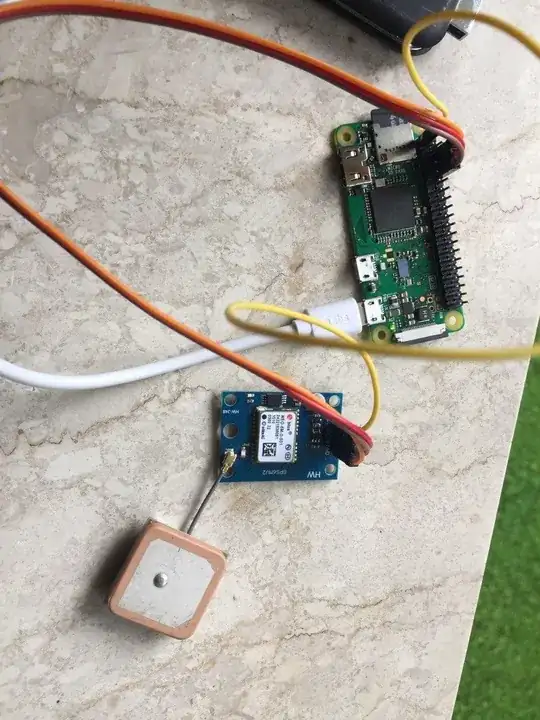

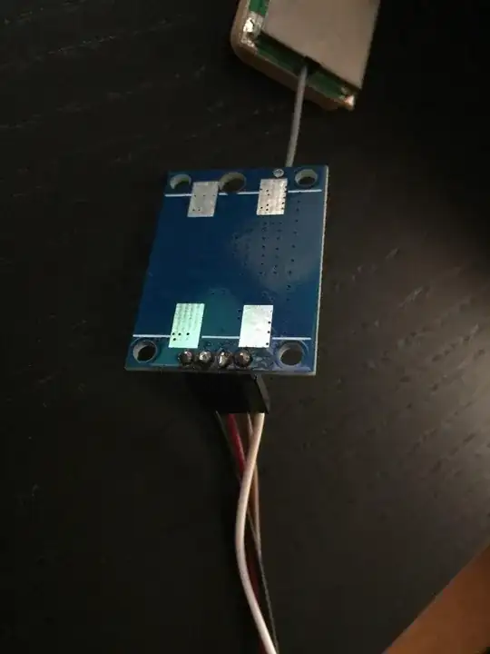

these are the connector and the multimeter sat between the first and the last 3.2-3.3 the soldering

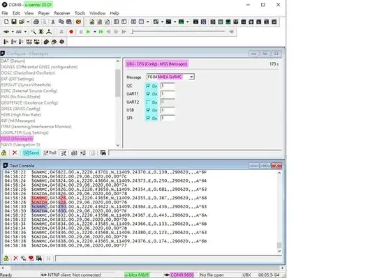

Part A - Using ublox u-centre
Part B - Using Rpi CuteCom
Part C - Using Thonny python

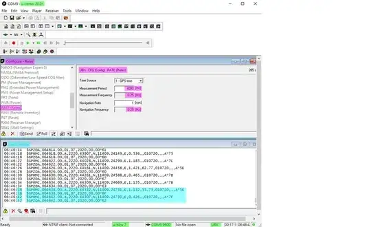

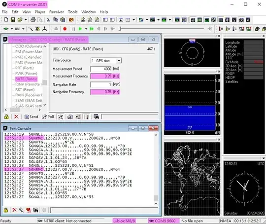

Part A - Using u-center to do the frequency setting
u-center screen below shows if measurement frequency is set to 0.25Hz, then the test measurements repeats every 4 seconds.
set rates

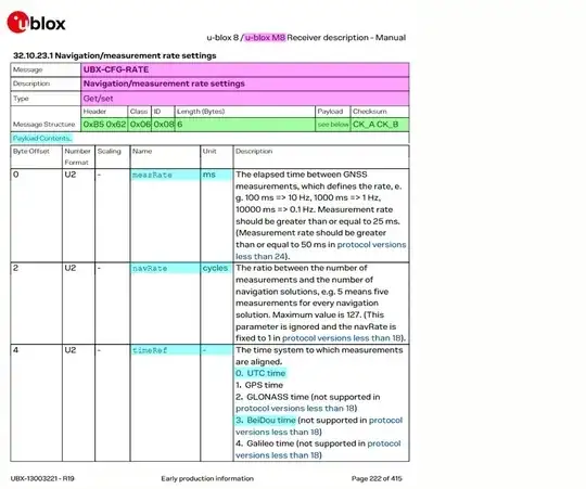

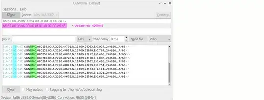

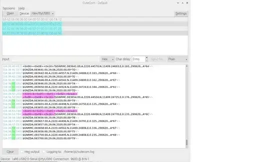

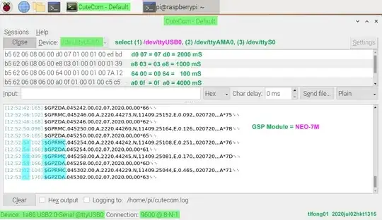

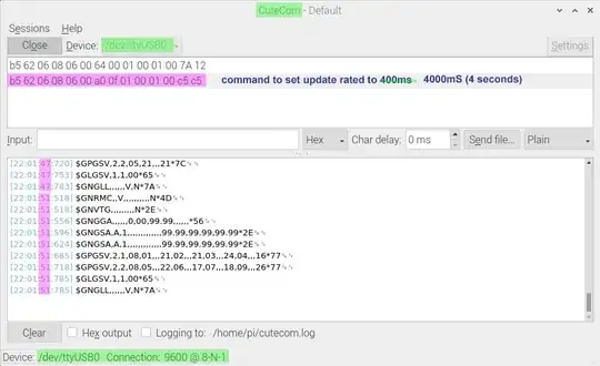

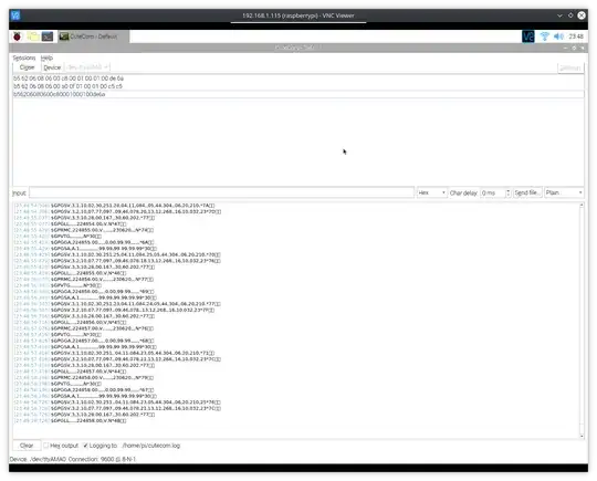

Part B - Using cuteCom to send UBX message to change update rate to 4 seconds

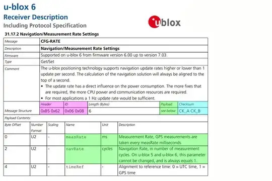

(1) Try end measurement/navigation frequency command with the two check sum bytes. See Appendix E for an example to calculate the check sum for a update rate to 4000mS command.
(2) Try end UBX message with CR, LF. (update - CR, LF is not necessary for hex input, only necessary for text input)
Note - it is much more newbie friendly to use GUI Rpi terminal emulator cuteCom than CLI bash echo and cat.
I have compiled a command message to set the measurement rate to 4 seconds. Then I used cuteCom to input the 14 byte command string to Neo-8M serial. Neo-8M accepted the command and measurement rate became 4 seconds.
set update rate

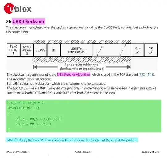

Appendix B - UBX Checksum
ubx checksum

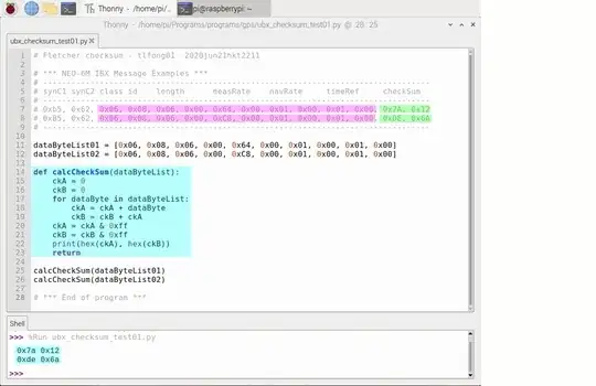

Appendix E - Python program to calculate checksum
# fletcher_chksum02.py Fletcher 8-bit checksum - tlfong01  2020jun22hkt2147

0xB5, 0x62, 0x06, 0x08, 0x06, 0x00, 0xa0, 0x0f, 0x01, 0x00, 0x01, 0x00, 0xC5, 0xC5 measRate 0xfa0 = 4000ms = 4.0 sec
dataByteList01 = [0x06, 0x08, 0x06, 0x00, 0x64, 0x00, 0x01, 0x00, 0x01, 0x00] dataByteList02 = [0x06, 0x08, 0x06, 0x00, 0xC8, 0x00, 0x01, 0x00, 0x01, 0x00] dataByteList03 = [0x06, 0x08, 0x06, 0x00, 0xa0, 0x0f, 0x01, 0x00, 0x01, 0x00] # measRate = 0xa0 0x0f = 0xfa0 = d4000
def calcCheckSum(dataByteList): ckA = 0 ckB = 0 for dataByte in dataByteList: ckA = ckA + dataByte ckB = ckB + ckA ckA = ckA & 0xff ckB = ckB & 0xff print(hex(ckA), hex(ckB)) return
calcCheckSum(dataByteList01) calcCheckSum(dataByteList02) calcCheckSum(dataByteList03)

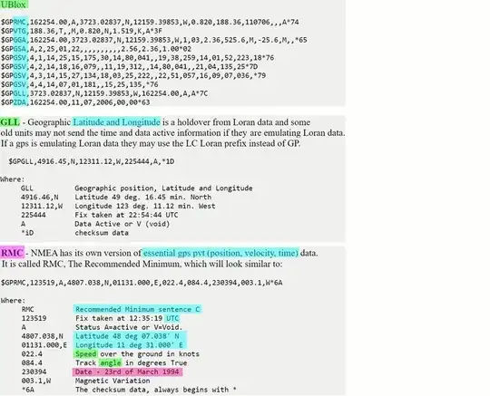

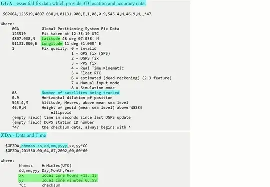

Appendix F - NMEA v3.01 data - gpsInfo.org
nmea sen 1a1
nmea sen 2b1
Appendix G - RMC, DZA Sentences Screen Capture
u-centre rmc zda msg

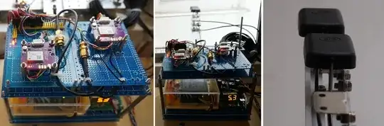

Appendix H - Dual Neo-8M Setup
dual neo 8m setup

[0x06, 0x08, 0x06, 0x00, 0xe8, 0x03, 0x01, 0x00, 0x01, 0x00]],
['Two Seconds Update Rate', [0x06, 0x08, 0x06, 0x00, 0xd0, 0x07, 0x01, 0x00, 0x01, 0x00]],
['Four Seconds Update Rate', [0x06, 0x08, 0x06, 0x00, 0xa0, 0x0f, 0x01, 0x00, 0x01, 0x00]
ubxNameCommandList = [ ['One Second Update Rate', [0x06, 0x08, 0x06, 0x00, 0xe8, 0x03, 0x01, 0x00, 0x01, 0x00]], ['Two Seconds Update Rate', [0x06, 0x08, 0x06, 0x00, 0xd0, 0x07, 0x01, 0x00, 0x01, 0x00]], ['Four Seconds Update Rate', [0x06, 0x08, 0x06, 0x00, 0xa0, 0x0f, 0x01, 0x00, 0x01, 0x00]] ]
def calcFletcher8BitCheckSum(dataByteListName, dataByteList): ckA = 0 ckB = 0 for dataByte in dataByteList: ckA = ckA + dataByte ckB = ckB + ckA ckA = ckA & 0xff ckB = ckB & 0xff print(' ', dataByteListName, ' ', convertOneByteNumToFourCharStr(ckA), convertOneByteNumToFourCharStr(ckB)) return
def convertOneByteNumToFourCharStr(oneByteNum): tempStr = ((hex(oneByteNum))[2:]) if (len(tempStr) != 2): tempStr = '0' + tempStr fourCharStr = '0x' + tempStr return fourCharStr
def testCalcChecksum(): testTitle = 'Calculate UBX Command Checksum' print('\nBegin Test', testTitle) print(' -------------------------------------') print(' Command Name Check sum') print(' -------------------------------------') for ubxNameCommand in ubxNameCommandList: ubxCommandName = ubxNameCommand[0] ubxCommand = ubxNameCommand[1] calcFletcher8BitCheckSum(ubxCommandName, ubxCommand) print(' -------------------------------------') print('End Test.')
*** Sample output tlfong01 2020jun29hkt1623 ***
''' Python 3.7.3 (/usr/bin/python3) >>> %Run neo8m_test08.py
Begin Test Calculate UBX Command Checksum
One Second Update Rate 0x01 0x39 Two Seconds Update Rate 0xed 0xbd Four Seconds Update Rate 0xc5 0xc5
End Test. >>> '''
Appendix J - CuteCom Screen Shots Showing Neo8M Config Command Acknowledgement Messages
ack msgs
Appendix K - Neo-7M Changing Update Rate to 4 seconds, Enable RMC and ZDA Only
neo-7m change update rate test
