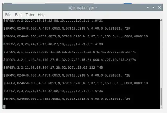

As can be seen, the sensor isn't getting the GPS values, $GPGGA,,,,,,0,00,99.99,,,,,,*48 (and most other fields) empty. I expect to see these values as in the screenshot below (from the link above). enter image description here

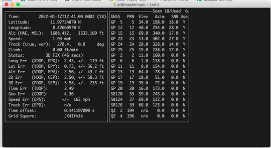

$ cgps -s
Output: enter image description here
Checking with python:
import gpsd
gpsd.connect()
packet = gpsd.get_current()
print(packet.position())
(11.9772487, 8.4266957)
