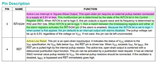

Disclaimer: I'm not sure I understand your question, and your objective doesn't make sense to me. Consequently, this may not really be an answer... but it's too long for a comment, so here goes:
I've some experience with the Pico Pi in C, but none with Python. I do know a little bit about the DS3231, but I've only used it with my RPi - not with the Pico. So - perhaps this will be helpful?

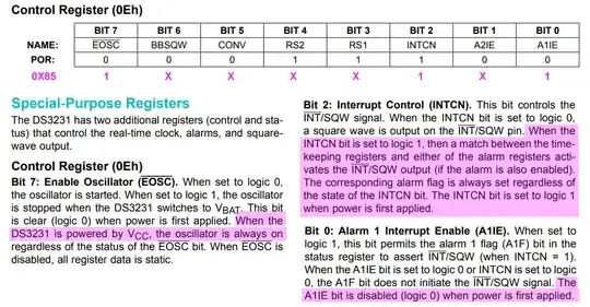

If you've not read the DS3231 data sheet, I would encourage you to do so as it may shed some light. The following passage from pg. 9 of the data sheet describes the functional logic of the #INT/SQW pin (note-emphasis is mine):
Active-Low Interrupt or Square-Wave Output. This open-drain pin requires an external pullup resistor connected to a supply at 5.5V or less. This multifunction pin is determined by the state of the INTCN bit in the Control Register (0Eh). When INTCN is set to logic 0, this pin outputs a square wave and its frequency is determined by RS2 and RS1 bits. When INTCN is set to logic 1, then a match between the timekeeping registers and either of the alarm registers activates the #INT/SQW pin (if the alarm is enabled). Because the INTCN bit is set to logic 1 when power is first applied, the pin defaults to an interrupt output with alarms disabled. The pullup voltage can be up to 5.5V, regardless of the voltage on VCC. If not used, this pin can be left unconnected.
Here's how I understand this wrt your question:
  • The INTCN bit controls whether pin 3 (#INT/SQW) outputs an INTerrupt, or a SQuareWave.
  • If INTCN is set to 0, a square wave is output; if INTCN is set to 1 the pin acts as an alarm. This assumes an external pullup is provided.
  • The default value for INTCN is 1; set at power-on. It may be changed to 0 by writing to the Control Register (0Eh) to enable the SQW function.
  • Consequently : you (or your Python library) must use the i2c bus to set INTCN bit to 0 by writing an appropriate value to the Control Register (0Eh).
  • I don't feel there is any ambiguity in the data sheet. While the passage quoted above doesn't specify what happens if the INTCN bit is set to 0, AND one/both of the Alarm Interrupt Enable (A1IE, A2IE) bits are set to 0. However, this is clarified on pg. 13 of the data sheet.
Setting the INTCN bit to 0 shouldn't be a huge problem; it's simply a matter of writing the appropriate value to the Control Register (0Eh) of the DS3231. But again, I've not used any Python libraries to do this.
However... In your question, you said: "I made sure to have a pulldown resistor, but it always reads high."
If that's an accurate statement, it's at least part of the cause of the issue you are seeing! Note the excerpt from the data sheet above says the #INT/SQW pin is an open-drain output!! Consequently, a pulldown resistor will do nothing. A pullup resistor to Vcc is required for the #INT/SQW pin to operate as advertised.
Once you connect a pullup resistor between #INT/SQW and Vcc, and assuming you have correctly set the INTCN bit to 0, you should get a square wave.
If you can't: There are apparently a lot of counterfeit DS3231 chips in the marketplace today from Chinese sources. I learned this during a tech support telephone call to Maxim. When I told the engineer that I had purchased my DS3231 on eBay, and paid less than $5 for it - he told me that I probably had a counterfeit, and he c/wouldn't answer my questions! We subsequently confirmed my DS3231 was a counterfeit from some external markings on the chip.
Now, as it turned out, my Chinese-manufactured DS3231 worked properly in my Raspberry Pi, but perhaps that was because I didn't exercise all the DS3231's available functionality? That's speculation of course, but I've since replaced my Chinese DS3231 with another RTC that is said to use a genuine DS3231 (hope so - it cost about $15!). And FWIW I can say that the SQW function does work in the "genuine" DS3231.

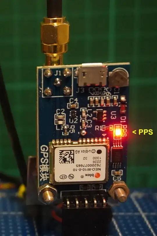

Appendix Y - Testing uBlox NEO 10M 1 PPS output
https://www.youtube.com/watch?v=qyCaoe4ZLX4 (YouTube video)
m10 pps 1
Appendix Z - uBlob NEO 10M - PPS (1 pulse per second testing)
pps 1

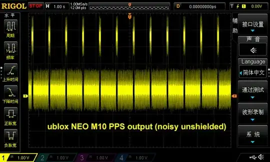

Appendix ZA - Neo M10 PPS noisy output
PPS output direct from M10 module 5 pin terminal is very noisy. Perhaps it is necessary to shield 2 metre long Win11 USB serial cable to reduce noise. Using Rpi picoW wiring should have very little noisy.
m10 pps 1

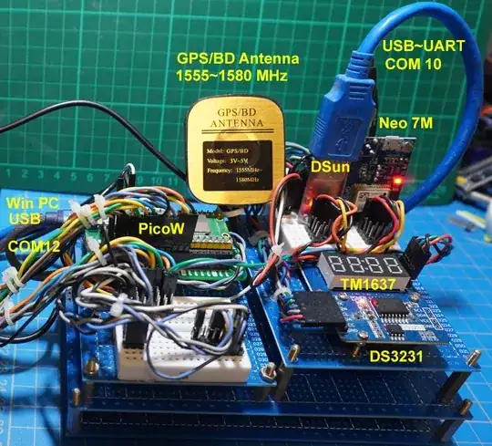

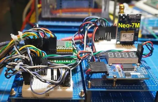

*** DS3231 RTC and uBlob Neo7M GPS DateTime (Appendix T)***
Neo7M + DS3231

The OP says the following:
"But I cannot get the SQW pin to pulse at 1hz. it is just high all the time. I made sure to have a pulldown resistor, but it always reads high."
Actually if the OP is using a assembled module like mine, then he does not need to use any pull up resistor, because there is already a 4k7 pull-up built in. So if he uses a pull-down resistor, the the Sq/INI pin with both a pull up and pull down resistor will form a potentiometer divider with a constant voltage output.

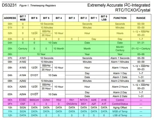

(C) DS3231 Registers Summary
(D) DS3231 Interrupt/Square wave pin description
int/sq pin description

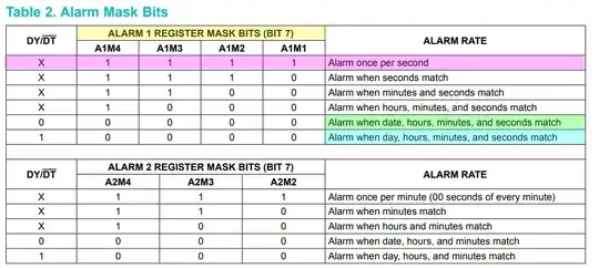

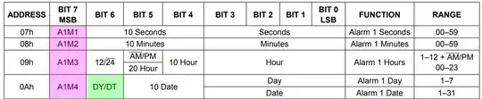

(E) DS3231 Alarm 1 setting (for interrupt once every second)
alarm reg
alam 1 set

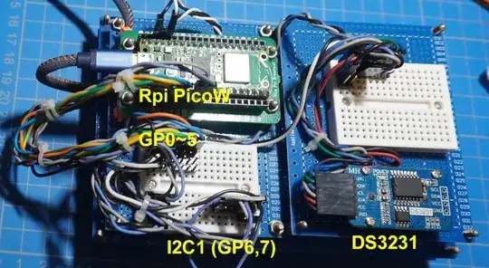

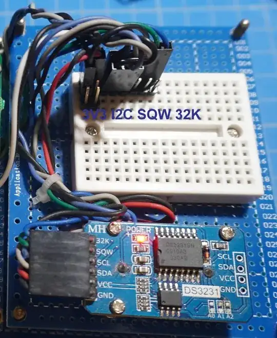

(G) DS3231 Wiring Scheme
picow + ds3231
(H) DS3231 on I2C1 detected OK (0x68 = DS3231, 0x53 = EEPROM)

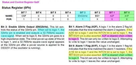

(I) How to reset interrupt using 0x0f register
status and control register

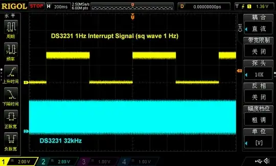

(J) Interrupt signal per second using 1 Hz Square wave clock
sq wve 1hz

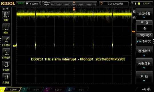

(L) Generate Alarm Interrupt every timer
The following program generate alarm interrupt every second. The while loop as the end of the program is to check if there is another alarm interrupt, and if yes, the interrupt flap at the status register 0x0f is executed to immediately clear the interrupt flag. Note - If there is no interrupt flag reset every time interrupt is detected, the scope will display just a zero volt/ground line.
1hz alarm interrupt

*** Function to scan I2C devices ***
def scanI2c(i2c): devAddrList = i2c.scan() return devAddrList
*** Sample test and ouput ***
def scanPrintI2cDevices(i2c): devAddrList = scanI2c(i2c) print(' I2C devices scanned =', end = '') for devAddr in devAddrList: print(' ', hex(devAddr), end = '') print('') return
*** Sample test and output ***
*** Sample Test ***
scanPrintI2cDevices(i2c1)
*** Sample output ***
>>> %Run -c $EDITOR_CONTENT *** Program = DS3231 Test v0.8 tlfong01 2023feb04hkt1211 *** Scan I2C devices = 0x57 0x68 *** End of Program *** >>> '''
*** Read/Write I2C device registers ***
def writeRegByte(i2cBus, i2cDevAddr, regNum, writeByte): writeByteArray = bytearray() writeByteArray.append(writeByte) i2cBus.writeto_mem(i2cDevAddr, regNum, writeByteArray) return
def ds3231WriteRegByte(regNum, writeByte): writeRegByte(i2c1, 0x68, regNum, writeByte) return
def readRegByte(i2cBus, i2cDevAddr, regNum): readByte = i2cBus.readfrom_mem(i2cDevAddr, regNum, 1) return readByte
def ds3231ReadRegByte(regNum): readByte = i2c1.readfrom_mem(0x68, regNum, 1) return readByte
*** Configuration ***
*** Control and Status Registers ***
ctrlRegNum = 0x0e statusRegNum = 0x0f
*** Alarm 1 registers and control bit/byte ***
alarm1SecRegNum = 0x07 alarm1MinRegNum = 0x08 alarm1HrRegNum = 0x09 alarm1DyDtRegNum = 0x0a alarm1RegTotal = 4 alarm1RegList = [alarm1SecRegNum, alarm1MinRegNum, alarm1HrRegNum, alarm1DyDtRegNum]
bit7SetByte = 0x80 alarm1RegInt1SecByteList = [bit7SetByte, bit7SetByte, bit7SetByte, bit7SetByte]
def setupAlarm1RegList(alarm1RegCtrlByteList): for i in range(alarm1RegTotal): ds3231WriteRegByte(alarm1RegList[i], alarm1RegCtrlByteList[i])
return
*** Test setup alarm 1 reg list and sample output ***
setupAlarm1RegList(alarm1RegInt1SecByteList) print(' alarm 1 reg list contents = ', end = '') for alarmReg in alarm1RegList: print(ds3231ReadRegByte(alarmReg), end = '')
*** Alarm 2 registers and control bit/byte ***
alarm2SecRegNum = 0x0b alarm2MinRegNum = 0x0c alarm2HrRegNum = 0x0d alarm2RegTotal = 3 alarm2RegList = [alarm2SecRegNum, alarm2MinRegNum, alarm2HrRegNum]
bit7SetByte = 0x80 alarm2RegInt1SecByteList = [bit7SetByte, bit7SetByte, bit7SetByte]
def setupAlarm2RegList(alarm2RegCtrlByteList): for i in range(alarm2RegTotal): ds3231WriteRegByte(alarm2RegList[i], alarm2RegCtrlByteList[i])
return
*** Test setup alarm 2 reg list and sample output ***
setupAlarm2RegList(alarm2RegInt1SecByteList) print('') print(' alarm 2 reg list contents = ', end = '') for alarmReg in alarm2RegList: print(ds3231ReadRegByte(alarmReg), end = '')
*** Setup Control registers ***
CtrlByteBase = 0x00 CtrlRegOscEnbl = 0x01 << 7 # ~EOSC CtrlRegIntCtrl = 0x01 << 2 # INTCN CtrlRegAlm1IntEnbl = 0x01 << 0 # AIIE
#Int1HzCnfgByte = 0x00 | (~CtrlRegOscEnbl) | CtrlRegIntCtrl | CtrlRegAlm1IntEnbl # 0x05 #SqWveCnfgByte = 0x00 | (~CtrlRegOscEnbl) | (~CtrlRegIntCtrl) | CtrlRegAlm1IntEnbl # 0x01
int1SecCnfgByte = 0x05 int1MinCnfgByte = 0x06
sqWveCnfgByte1Hz = 0x01 sqWveCnfgByte1kHz = 0x19
*** Setup Ctrl Reg 0x0e with ctrl byte 0x05 ***
print('') print(' int1SecCnfgByte = ', hex(int1SecCnfgByte)) print(' int1MinCnfgByte = ', hex(int1MinCnfgByte)) print(' sqWveCnfgByte1Hz = ', hex(sqWveCnfgByte1Hz)) print(' sqWveCnfgByte1kHz = ', hex(sqWveCnfgByte1kHz))
*** Config Int 1 sec/1min, Square Wave 1Hz/1kHz ***
#ds3231WriteRegByte(ctrlRegNum, sqWveCnfgByte1Hz) #ds3231WriteRegByte(ctrlRegNum, sqWveCnfgByte1kHz)
#ds3231WriteRegByte(ctrlRegNum, int1SecCnfgByte) ds3231WriteRegByte(ctrlRegNum, int1MinCnfgByte)
readByte = ds3231ReadRegByte(ctrlRegNum) print(' readByte from ctrlReg =', readByte)
*** Read status rgister / reset interrupt flass / Enable/Disable clock 32 kHz signal ***
statusByteBase = 0x00
#clock32kHzEnbl = 0x01 << 3 #alarm2FlagReset = 0x01 << 1 #alarm1FlagReset = 0x01 << 0 #resetAlarmsByte = statusByteBase | alarm1FlagReset | alarm2FlagReset | clock32kHzEnbl # 0x00 #ds3231WriteRegByte(statusRegNum, resetAlarmsByte) resetAlarmByte = 0x00
*** Generate interrupt every second ***
print(' Generate interrupt every second') ds3231WriteRegByte(ctrlRegNum, int1SecCnfgByte) #generate interrupt every second
*** Reset interrupt flag every 50mS ***
while True: ds3231WriteRegByte(statusRegNum, resetAlarmByte) time.sleep_ms(50)
print('*** End of Program ***')
*** End of program ***

(N) The OP's "Battery Power Clock" vs TM1637 4 digit display module
The OP wishes the 1 second interrupt to tick a battery powered clock. It is no clear which clock he is referring to. So a randomly googled a 4 digit display for testing.
tm1637 4 digit display module
(1) TM1637 Based 4 Bits Red Digital Tube LED Display Module - Rajguru
(2) TM1637 Module 4 digit display led 7 segments Display Tube Decimal Module with clock - HK$9
(3) MicroPython TechNotes: 7 Segment Display - TechToTinker
(4) MicroPython TechNotes: 7 Segment Display - TechToTinker
(5) How to use TM1637 4-digit 7-segment LED display with Arduino | Quick & Brief Tutorial - How To Electronics
(6) LCD 16x2 display for digital clock WuSiYu/python-i2clcd Public
(O) Testing TM1637 OK
I installed PyPi's TM1637 module to PicoW and found basic testing OK, including a simple teething problem: Need to replace integers 4, 5 by objects Pin(4), Pin(5)
tm1637 test
(1) Using 7-Segment Display TM1637 with Raspberry Pi Pico - HowToElectronics, 2022sep30
(2) pypi tm1637 - PyPi Project
It takes only two statements to do the above "All LEDs On" demonstration.
# *** tm1637 4 digit LED display/clock
tm = tm1637.TM1637(clk = Pin(5), dio = Pin(4))
all LEDS on "88:88"
tm.write([127, 255, 127, 127])

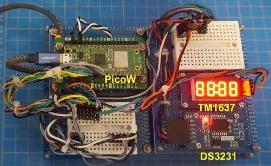

(P) Interfacing TM1637 with DS3231
I am searching my old DS3231 test programs in rpi.forum to refresh my memory on how to interface DS3231 hardware:
(1) Search found 51 matches: ds3231 tlfong01 - forums.rpi.com 2023feb10hkt1534
(2) Rpi4B Realtime Clock Testing Notes 1 - Rpi.com.Forum 2018Aug06
(3) Rpi4B Realtime Clock Testing Notes 2 - Rpi.com.Forum 2018Aug06
(4) Rpi4B Realtime Clock Testing Notes 3 - Rpi.com.Forum 2018Aug06

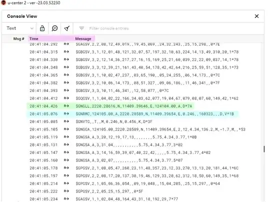

(U) GPS NMEA message
nmea 2
nmea 3
(V) ublox ucenter user guide
ucentre user guide

Appendix X - Ublox Ne-10M Module (GPS Time 1PPS (Pulse Per Second Signal Testing Notes 1)
m10 - 1
m10 - 2
m10 - 3
