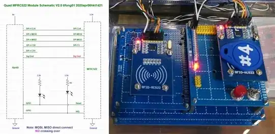

Part A - RFID Reader Triangulation
rfid reader
See Refs 1, 2

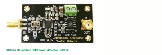

Part B - RF Detector Triangulation
RF Detector
See Refs 3, 4

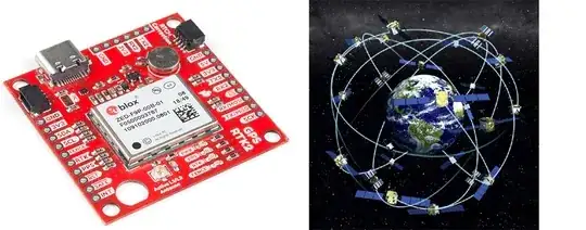

Part C - GPS Satellites Multiangulation
ublox GPS-RTK2 Board (10mm accuracy) - SparkFun
And you can use a GPS board to do not only triangulation, but with 2,500+ satellites to multiangulate, to 10mm accuracy.
