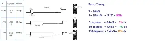

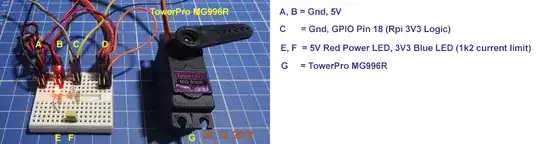

Pictures showing how Rpi PWM GPIO can move servo motors
rpi servo 1
rpi servo 2
rpi servo 3
rpi servo 4

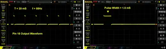

(2) Program to display PWM wavefrom on scope
To display PWM waveform
def servoPwmBasicTimingTestGpioPin18():
    print('  Begin servoPwmBasicTimingTestGpioPin18, ...')
gpioPinNum         =   18
sleepSeconds       =  120
frequency          =   50
dutyCycle          =    7
setupGpio()
setGpioPinOutputMode(gpioPinNum)
pwmPinObject = setGpioPinPwmMode(gpioPinNum, frequency)
pwmPinStart(pwmPinObject)
pwmPinChangeFrequency(pwmPinObject, frequency)
pwmPinChangeDutyCycle(pwmPinObject, dutyCycle)
sleep(sleepSeconds)
pwmPinObject.stop()
cleanupGpio()
print('  End   servoPwmBasicTimingTestGpioPin18, ...\r\n')
return
