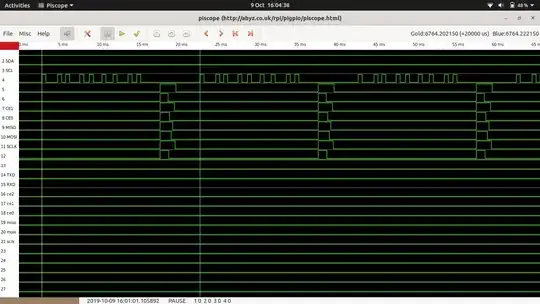

The following code will read a PPM signal on IN_GPIO and generate a servo pulse per channel on OUT_GPIO.
It runs for 60 seconds by default.
#!/usr/bin/env python
import time
import pigpio
IN_GPIO=4
OUT_GPIO=[5, 6, 7, 8, 9, 10, 11, 12]
start_of_frame = False
channel = 0
last_tick = None
def cbf(gpio, level, tick):
   global start_of_frame, channel, last_tick
   if last_tick is not None:
      diff = pigpio.tickDiff(last_tick, tick)
      if diff > 3000: # start of frame
         start_of_frame = True
         channel = 0
      else:
         if start_of_frame:
            if channel < len(OUT_GPIO):
               pi.set_servo_pulsewidth(OUT_GPIO[channel], diff)
               print(channel, diff)
               channel += 1
   last_tick = tick
pi = pigpio.pi()
if not pi.connected:
   exit()
pi.set_mode(IN_GPIO, pigpio.INPUT)
cb = pi.callback(IN_GPIO, pigpio.RISING_EDGE, cbf)
time.sleep(60)
cb.cancel()
pi.stop()
Example input and corresponding output.

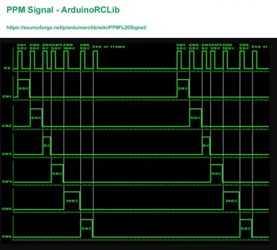

Let us use the following ArduinoRCLib PPM signal (Ref 8) as an example, and write a couple of python functions:
(1) To output the example PPM signal in Rpi4B buster release 2019spe26 GPIO output pin #18, using Thonny 3.2, python 3.7.4
(2) To input the above signal from GPIO output pin # 18 to GPIO input pin #19
(3) To convert the input PPM signal to PWM signal.
(4) To output the converted PWM signal to GPIO output pin #20.
ppm signal
ArduinRCLib 5 Channel PPM Signal Analysis
Pulse 1 - Ch 1 = 50%
Pulse 2 - Ch 2 = 50%
Pulse 3 - Ch 3 = 0%
Pulse 4 - Ch 4 = 50%
Pulse 5 - Ch 5 = 100%
Pulse 6 - Ch 6 = 50%
Pulse 7 - End of PPM frame
PPM/PWM Hardware Testing Setup

Rpi python Sample PPM Signal Frame Generation Program V0.1 Design Notes
PPM Sample Frame Spec V2.0 (Only 4 channels for Rpi)
  1. High state > 2mS
  2. Channel 1 pulse = duty cycle 50%
  3. Channel 2 pulse = duty cycle 100%
  4. Channel 3 pulse = duty cycle 0%
  5. Channel 4 pulse = duty cycle 50%
  6. End of frame pulse = sync pulse = 8mS Low
Notes
  1. Servo PWM pulse width = PPM high state + 0.3 × (PPM low state)
  2. Signal Low state always = 0.3mS
Need to google further to find most popular standard of end of frame pulse, Low pulse width etc, before starting to write the python PPM frame generation function. (see Appendix B for testing and pulse timing functions )

Appendix A - PPM Signal Spec
(1) PPM encoding for radio control - Wikipedia
A complete PPM frame is about 22.5 ms, and
signal low state is always 0.3 ms.
It begins with a start frame (high state for more than 2 ms).
Each channel (up to 8) is encoded by the time of the high state
(PPM high state + 0.3 × (PPM low state) = servo PWM pulse width).
(2) PPM Signal - agert.eu
Sync pulse = 8mS low pulse

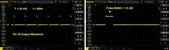

Appendix B - Demo Program #1
Function
  1. Set GPIO pin 18 high for 2 seconds, to switch on Blue LED to full brightness.
  2. Set the same GPIO pin 18 to output PWM of 1kHz, 50% duty cycle, to switch on/off Blue LED to result half brightness.
Pin 18 waveform
# Servo_test32 tlfong01 2019may12hkt1506 ***
