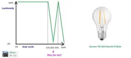

For my case, the led is acting strangely. With a 5000Hz frequency, changing the duty cycle from 0% to 70% doesn't change it's luminosity, 70% to 86% reduce the luminosity, 86% to 95% increase it and 95% to 100% reduce it again. But the led is always turned On, even if the duty cycle is at 100% the led emits a little light.
Here a graph to better illustrate the situation. Graph illustrating the luminosity of a led depending on the duty cycle
The Python code used is from the youtube tutorial, do someone understand why the max duty cycle used is 86% ?
Why is the dimming not linear ?
And why the led cannot be totally turned Off using a 100% duty cycle ?

(A) Why there is a weird dip at duty cycle 85%?
(B) Why dimming not linear?
(C) Why use PWM frequency 5kHz?
(D) Why limit duty cycle to 86%?
(E) Why LED not completely switch off at duty cycle 0%
/ to continue, ...

(A) There is no reason for a dip. Your program might be buggy. Try my bug free Rpi GPIO PWM python programs! :) (Refs 5, 6).
(B) Dimming not linear because your eyes are logarithmic, which is non linear.
(C) There is no reason to use PWM frequency 5kHz. AC mains frequency is 50/60Hz. So a "sampling" frequency 10 times of that should be flickering free. Try 1 kHz and try and error a pleasant frequency for your eyes only.
(D) There is no reason for a 86% duty cycle limit. Try and error higher. Nothing will explode.

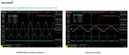

(E) Perhaps there is sort of a "dead band" at AC mains voltage cross over. As soon as zero cross is detected, it take a little bit of time to tell the triac to cut off off current (just guessing, not very sure).

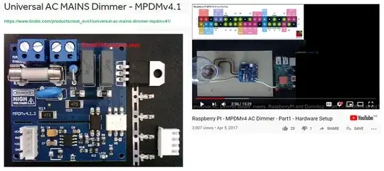

(1) MPDM V4.1 Documentation
(2) Universal AC MAINS Dimmer MPDMv4.1 Catalog- US$17

Appendix B - MPDM v4.1 Universal AC Current Dimmer
mdpm v4

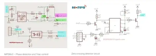

Appendix C - Zero detection and triac switching schematics
triac schematics
Appendix D - MPDM Traic Operation Explained - NetEvo
Triac operation
