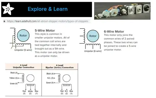

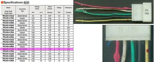

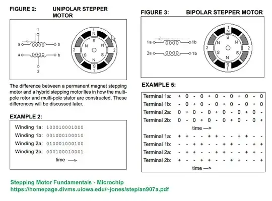

I did the same thing a long while ago. I vaguely remember I performed the following operation converting the stepper from unipolar to bipolar.
  1. Open the casing
  2. Cut away the red wire, so that the two windings do not electrically connected to each other.
unipolar to bipolar
Now I am googling something to read, and jot down some pictures, ...
uni and bipolar stepper

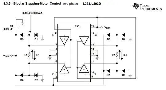

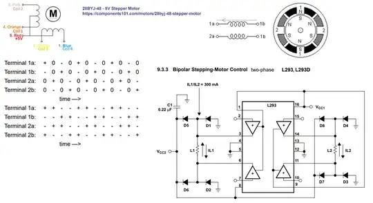

Now the schematic for L293D driving a bipolar stepping motor.
l293d stepping motor

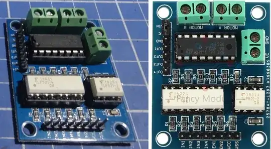

I have found a L293D module in my junk box.
l293d module
Now I have shrinked and merged 4 big pictures into one big picture for my small eyes to look at.
big picture

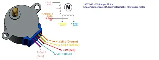

The problem is we don't know the colour code of the wiring scheme. For example, what colour is for 1a, 1b, 2a, 3b etc. If we could not find the colour code, we may need to use the multimeter and a 6 battery to find by trial and error manually.
colour code

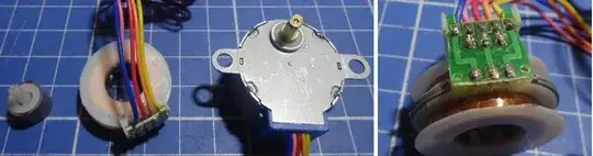

Anyway, now I have removed the casing of the 5 wire unipolar motor. Next step is find out which trace to cut to separate the two coils sticking together at the red wire, to make it a 4 wire, two non connecting coils, red wire don't care bipolar motor.
5 wire 4 wire operation

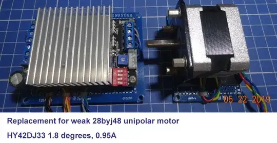

Now I am also thinking of testing my old stepper and compare how more powerful is, comparing to the small guy. The old guy costed me US$2 (a couple of years ago). The wires were badly torn, but I know there is no contact brushes to wear, so found it good and quite. A new one costed US$25. I thought it was very good money for a hobbyist to play with and learn something. As a newbie, I needed to google hard before I know how to use a battery, a multimeter, and a 1 pole, 12 throw to figure out which wire goes with which other wire, ...
old stepper 1
old stepper 2
A stronger stepping motor to replace 28BYJ48, should be strong enough to turn Rubik cube
