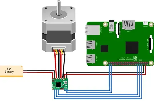

Something like this:

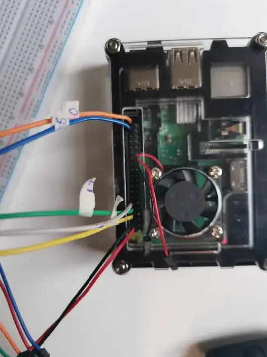

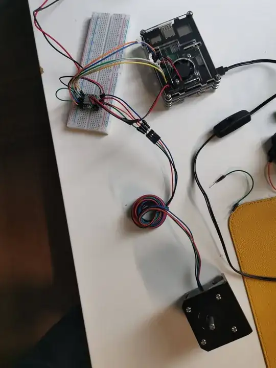

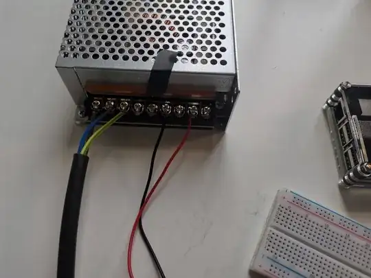

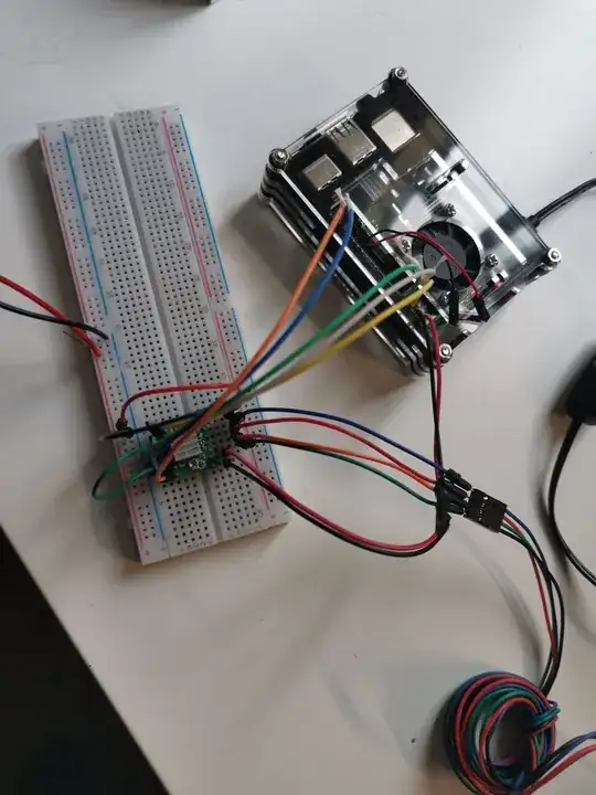

I paste photos of the connection:
enter image description here enter image description here enter image description here

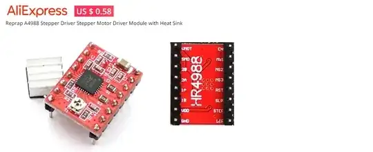

Appendix A - The A4988 stepping motor driver module used in this answer
(2) A4988 Stepper Motor Driver Module – AliExpress US$0.6
a4988 module

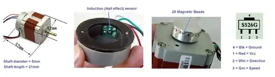

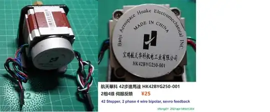

Appendix B - The NEMA17 stepping motor tested in this answer
(7) AliExpress HK42BYG250-001 Stepper Motor NEMA17 | High torque 1.2A 38mm stepper motor for 3D printer 42 with speed feedback - CN¥25
stepper motor 1
stepper motor 2

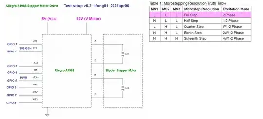

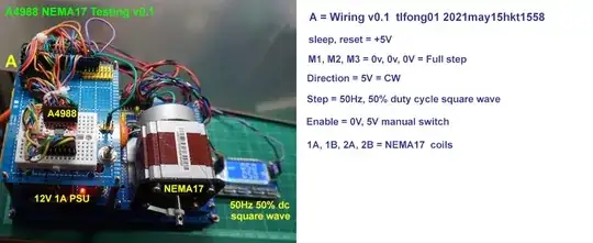

Appendix C - A4988 Stepping Motor Driver and NEMA17 Stepping Motor Test Schematic
a4988 full step test

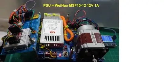

Appendix D - 12V 1A PSU for NEMA17 Stepping Motor
psu 12V 1A
