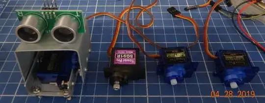

I am day dreaming of assembling a Google like self driving toy car. I have DIYed a tilting platform holding the ultrasonic sensor, controlled by one servo, and the platform controlled by another stepping motor or servo, which should turn 360 degrees, ...
servo car
