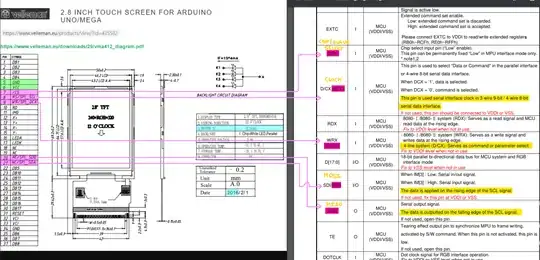

UPDATE PROGRESS: enter image description here vma412_diagram / datasheets - ILI9341

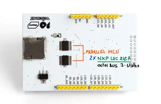

enter image description here data-sheet 74LVC_LVCH245A enter image description here
PCB screen side enter image description here

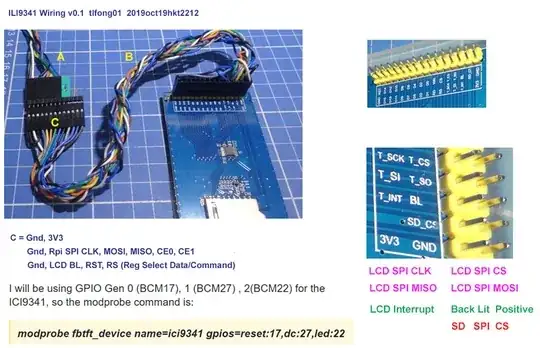

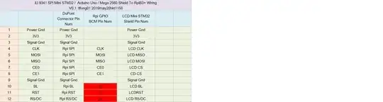

Yes, it is OK to use the ILI9341 Arduino Shield for Rpi. The following is the wiring for using SPI mode interface.
ILI9341 Touch LCD Arduino/STM32 Shield to Rpi3B+ GPIO Wiring V0.1
ici9341 wiring

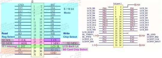

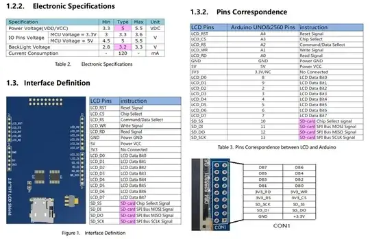

First thing first - check out spec and schematic.

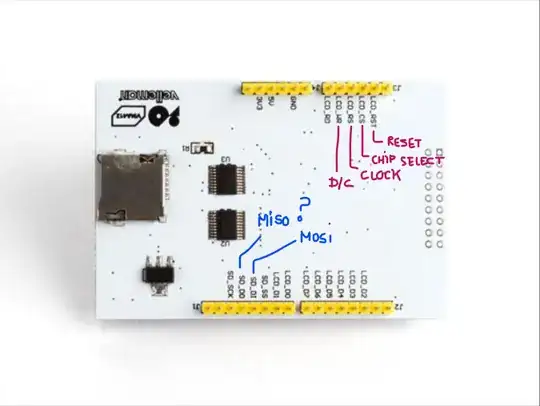

touch screen 01
touch screen 2

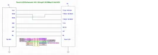

The OP's question is clear, and his reference web links are very good. So I followed his links and jot down a picture of the wiring.
touch screen wiring

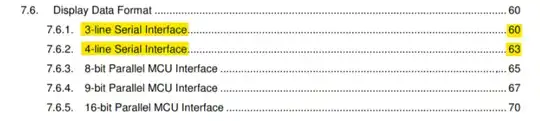

so I googled and found everybody is using the ILI19341 de facto standard. That means all ILI19341 are more or less the same and can be used with any such driver. I searched AliExpress and found the following typical goody.
ILI19341 touch screen
I google to catch up and the the found the following tutorial looking good.
ILI9341 Raspberry Pi guide - pi0cket 2019feb26
It gives a clear wiring (see Reference below), and the detailed instructions and commands to switch between HDMI mon and TFT screen.
One thing I am not that happy is the following:
You cannot use HDMI monitor and TFT touch screen at the same time!

Fig 1 Fig 1 - Touch LCD
Fig 2 Fig 2 - 2.8" touch screen pinout
Fig 3 Fig 3 - STM32 LCD Module 32 pin socket

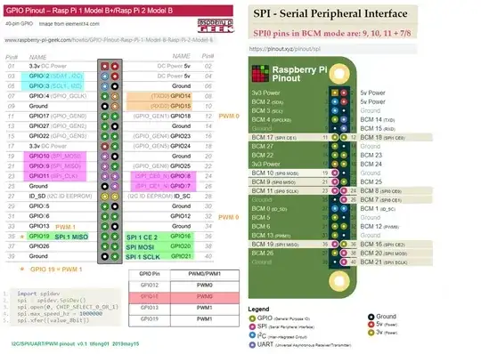

Fig 4 Fig 4 - Rpi spi pinout

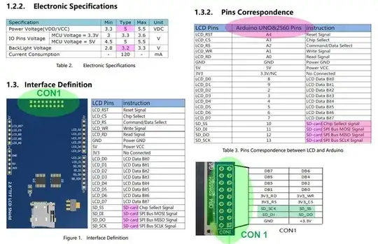

Fig 5 Fig 5 - Touch lcd wiring

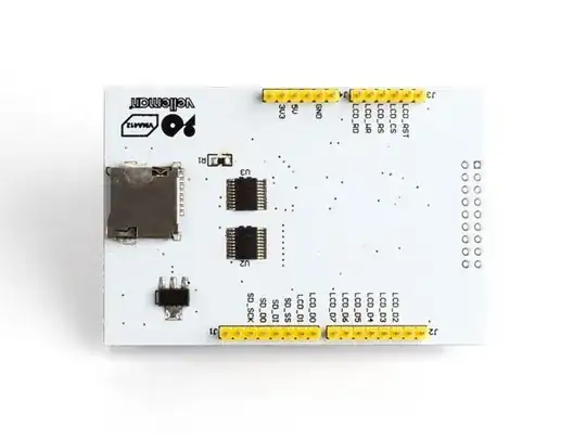

Fig 6 Fig 6 - Touch screen module
Fig 7 - Con 1 - 9 pin x 2 = 18 pin Connector
Con 1 - 9 pin x 2 = 18 pin connector
Fig 8 - vm412 Touch LCD signals
velleman lcd 01
Fig 9 - stm32 Touch LCD signals
stm32 signals

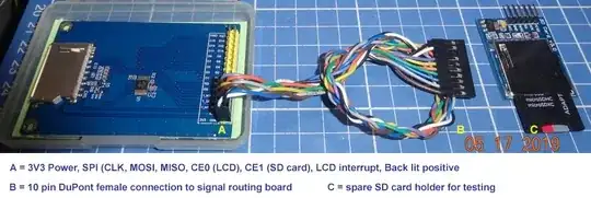

Fig 12 - SPI Signal Routing Cable
spi signal cable

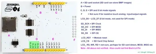

Now I am testing Back Lit. I found that my guess was wrong. The pin BL is not LED anode, but Low level on. I used a multimeter to check that the current from BL pin to ground is 2.5mA. So I now guess BL is not a signal pin but a pull down LED power pin, sinking 2.5 mA to switch on Back Lit LED. Anyway, I am glad that now I have a huge size 2.8" white LED! :)
bak lit test

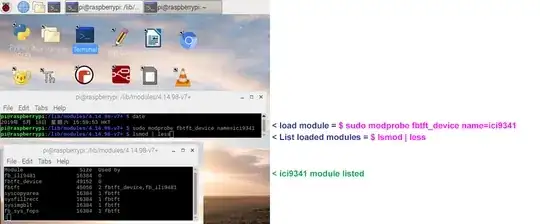

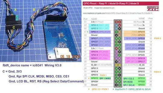

Now I have loaded the kernel module fbtft_device name = ici9341. I can also listed the module. But I found that I made another wrong guess - four SPI signal wires are not enough, I also need 3 more GPIO wires RST, DC (select Data or Command mode), and BL (back lit), ... :(
fbtft_module_loading
My ICI9341 SPI cable V2.0 does not work, because the signals Touch LCD RST and RS (Register Select) or DC (Data Command Mode Select) are missing. So I have assembled V3.0.
ici9341 cable
I will be using GPIO Gen 0 (BCM17), 1 (BCM27) , 2(BCM22) for the ICI9341, so the modprobe command is:
modprobe fbtft_device name=ici9341 gpios=reset:17,dc:27,led:22

Appendix A - ILI9341 Touch Screen Wiring V0.1 tlfong01 2019oct19hkt2217
ili9341 wiring

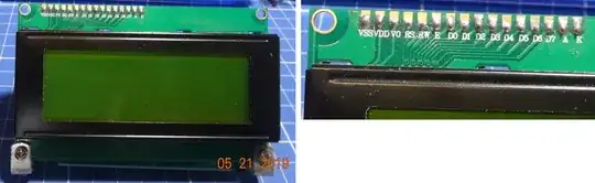

I do not know if you fixed issues already but you cannot connect your 8bit paralel tft display via SPI. SPI interface uses less wires for connection as 8-bit parallel which is yours case. At first check what display do you have. you can see it on notro wiki: https://github.com/notro/fbtft/wiki/LCD-Modules . From pictures you posted you have 8-bit parallel interface (dc, wr, reset, cs, db00-07). You can follow also this page: https://github.com/nopnop2002/Raspberry-ili9325/wiki/FrameBuffer-Setting-to-ILI9341, where you have also gpio numbers for connection to display
