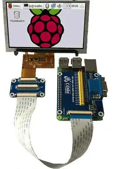

I am running Raspbian 4.19.34 with HDMI monitor (FullHD). I bought 5" LCD which connects to Raspberry using GPIO pins (by rpi rgb lcd and vga board).
I am trying to get it to work like 2 screens.

5" LCD connect to Rpi using GPIO pins (by rpi rgb lcd and vga board).

rpi vga screen

I skimmed the RGB/VGA card setup guide which tells you how to edit the Rpi config.txt for the RGB/VGA configuration. I think this meanss that they designed this VGA card for those who prefer to use ONLY ONE 5/7" SMALL MONITOR, instead of HDMI. So I think if you want to use two displays, you can forget this VGA card and look for options, ...
Raspberry Pi RGB VGA 800x480 Kit
How to setup the RGB VGA board for Rpi
Insert the SD card to your computer.open the file "config.txt" at the SD card root directory by your computer
Add the following code at the end of the file,Then save the changed file
If 800x480 Resolution LCD(such us 5 inch,7 inch): dtoverlay=dpi24 ...
Insert the SD card to your Pi. Then work
