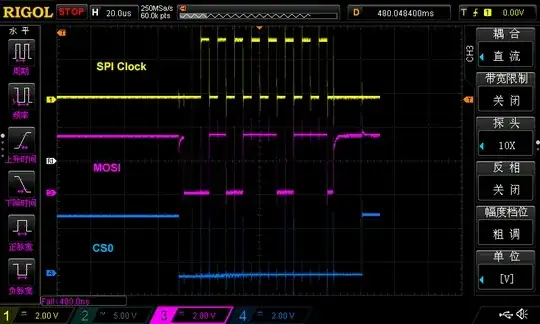

I tried it on both Raspi 3 and 2 using the SpiDev python library.
I've never even seen any kind of output on MOSI or CS lines with my oscilloscope.
Controlling an SH1106 OLED display via the luma.oled lib works however AND generates signals on the MOSI line.
Also, manually driving the GPIOs works just fine.

You might like to try my little test program, under GUI Desktop IDLE python. Or run under terminal mode with sudo.
rpi3b+ python spi
# spi_test05 tlfong01 2019apr07hkt2043 ***
# Computer = Rpi3B+
# Linux    = $ hostnamectl = raspberrypi Raspbian GNU/Linux 9 (stretch) Linux 4.14.34-v7+ arm
# Python   = >>> sys.version = 3.5.3 Jan 19 2017
# Test 1   - repeatSendByte() - SPI port repeatedly send out single bytes.
# Function - Repeat many times sending a byte, pause after each byte.
# Test 2   - loopBackTest()   - SPI port send and receive one byte.
# Function - Send one byte to MSOI and read it back from MISO.
# Setup    - Connet MOSI pin to MISO pin to form a loop.
