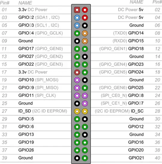

Not sure what's happening here, everything should work. Tried different cables, different pins on the analyzer, different laptop... the CE0 line won't go low.
Currently MOSI sends bits and the clock is activated so I can only assume that the clock select is driving low.
I have wired up according to this diagram...
EDIT: adding wiring for completeness
Pin 19 - GPIO10 -> MOSI Pin 21 - GPIO09 -> MISO Pin 23 - GPIO11 -> CLK Pin 24 - GPIO8 -> CEO_N Pin 26 - GPIO7 -> CE1_N
I have tried using the CE1_N pin (according to above diagram), I have tried setting the alternate function on the pin, I even tried turning autocs off and manually driving a gpio (which is actually working).
Is there a step I'm missing? Is this diagram accurate? I don't think I need to set alternate functionality as the other SPI lines seem to work just fine.
I would be grateful for any suggestions.
