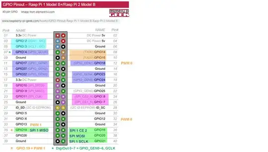

I also attach the SPI 2 pinout for your reference.

spi pinout
