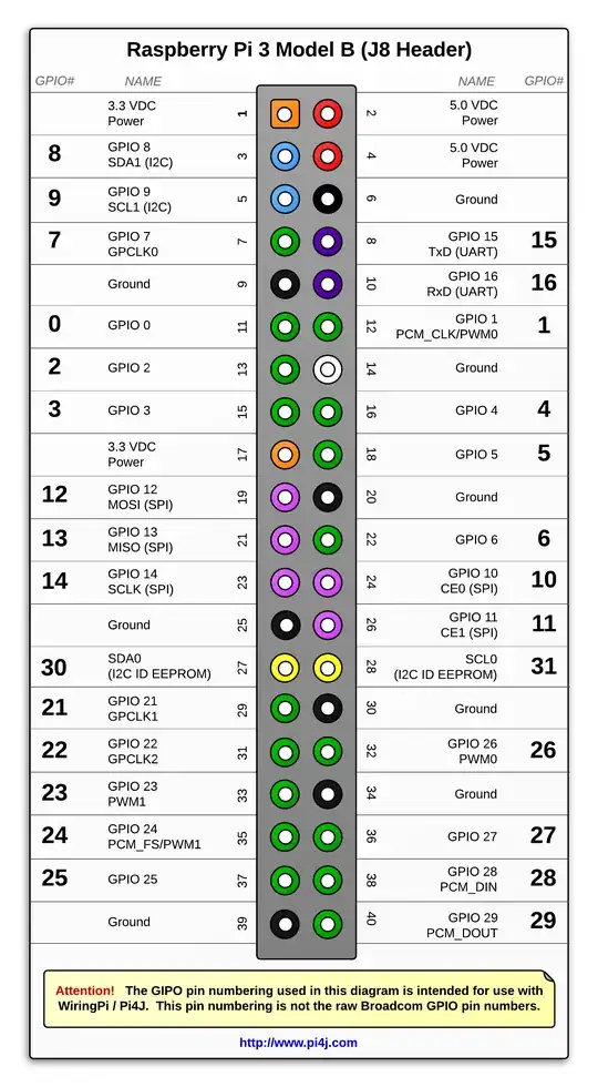

Hardware: Raspberry Pi 3 Model B V1.2
spidev module documentation: http://tightdev.net/SpiDev_Doc.pdf
Pinout: enter image description here
