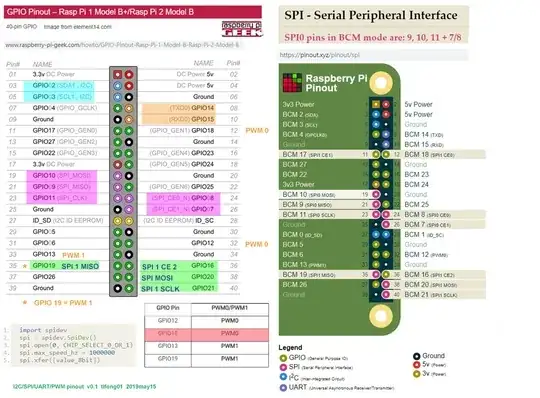

What I might seem to be stuck on are the used gpio pins, I have no idea which of them I should use, the above java-code is just trial and error. I hope I havent broken it. Thoughts?

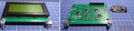

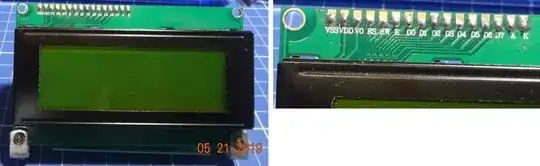

If you don't see the characters or blank 5x7 dots character matrices, you need to adjust the pot fully CW and CCW to display them.
I still remember vividly that the first time I spent long hours and much effort and did everything correct, but -
THE CHARACTERS DID NOT SHOW UP, UNTIL I ADJUST THE BACKGROUND BRIGHTNESS!

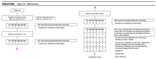

Hitachi HD44780U Dot Matrix LCD Controller Rev. 0.0

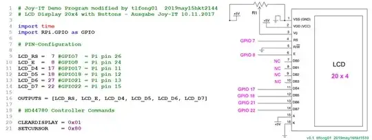

Joy-IT Demo Program modified by tlfong01 2019may15hkt2144
LCD Display 20x4 with Buttons - Ausgabe Joy-IT 10.11.2017

Appendix C - LCD Init 4 bit sequence
lcd init sequence

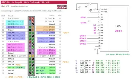

Appendix D - LCD 20 x 4 Schematic
lcd20x4 wiring
Rpi GPIO BCM GPIO pin numbering vs 40 pin connector board physical position numbering
rpi gpio pin numbering
