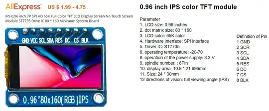

That looks similar to this display breakout from Adafruit, and uses a driver chip with almost the same model number. I notice doing a quick search that there are a lot of such things using an ST7735S driver; the Adafruit one is ST7735R, and I did find one on AliExpress with ST77355. Unfortunately that one is in Polish, but spotting things like 5V or 3.3V are fairly language agnositic -- but not on that page.
Based on all that, I would guess the chip itself is 3.3V and the breakouts they are sold on often add a level shifter so you can use them with Arduinos, which use 5V logic. The issue then is whether this is configured, as with the Adafruit one, to also be 3.3V friendly. However, if the device can run off 3.3V, which I am pretty sure you can safely try, then it would not be possible for it to step the logic voltage up (otherwise, the 5V signal could damage the Pi).
Beyond that, the breakout in your picture looks to have an I2C interface (SCL + SDA), which is a standardized bus protocol and available on the Pi -- although it says "SPI" on the back, and some similar items are sold as such, the Pi has a SPI bus too.
So, if you can, try to find one that explicitly says 3.3V logic is okay. If it doesn't say that but doesn't say anything contradictory, it is probably a safe bet anyway.

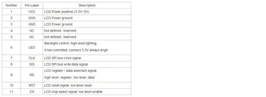

  1. Well, most ST7735 LCD are for Arduino and STM32. It is just SPI, so you can use Rpi to talk to it, but you might need to build your own kernel module - LCD TFT screen 2.8" ILI9341 SPI connect Errata - Actually there is a python library - see Appendix A below
  2. You might like to start with the AliExpress review (see references below).
  3. You need know a little bit of google fu to find the pinout.
