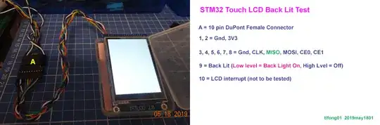

White Screen Testing
white screen

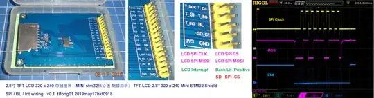

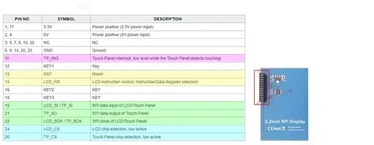

(1) Your touch screen seems to use the ILI9341 driver (Ref 1)
(2) You can google video tutorials to find more details (eg Ref 2, 4)
(3) Depending on your config: Rpi3B+/Rpi4B stretch/buster version/released dates etc, and whether you are using 3/4 pin SPI or 16 GPIO pin connector mode, you might need to build your own driver/kernel module (Ref 3)
A white screen usually means at least the back lit LED is working. You need to install the driver to display. Ref 3 shows how to get the white screen and build a kernel.

(6) Rpi ILI9341 / XPT2046 SPI 3.2" Touch LCD Display - LCwiki

Appendix A - Wiring Notes v0.1
touch lcd wiring
