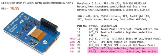

Let me see. Your touch screen needs 2 chip selects. So it uses up Rpi's only two chip selects CS0, CS1.

But there is one catch. In the above methods, you forget the Rpi chip selects (just disconnect them), and use you own chip selects. This works for all the SPI devices I work so far, except those like WaveShare touch LCD, which uses their own drivers, insisting to use Rpi's CS0, CS1.
Of course you can mess around WaveShare's driver software, but that is very difficult for newbies, and not linux version invariant.

waqveshare touch ldc
WaveShare 3.5inch RPi LCD (A), 480x320 US$23.99
WaveShare 3.5inch RPi LCD Technical Notes
320 x 480, 8:5, 65536 colours, TFT, Backlight LED,
SPI, Touch Screen Resistive, Controller XPT2046,
PIN NO. SYMBOL  DESCRIPTION
11  TP_IRQ  Touch Panel interrupt, touch detect low
18  LCD_RS  Instruction/Data Register selection
22  RST Reset
19  LCD_SI / TP_SI  SPI data input of LCD/Touch Panel
21  TP_SO   SPI data output of Touch Panel
23  LCD_SCK / TP_SCK SPI clock of LCD/Touch Panel
24  LCD_CS  LCD chip selection, low active
26  TP_CS   Touch Panel chip selection, low active

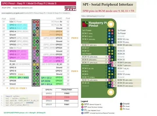

If you don't wish to replace SPI MCP3008 by another I2C ADC, you can consider use Rpi's second set of SPI. Again this is hard for newbies. Below is a picture for you to start exploring.
Second SPI
